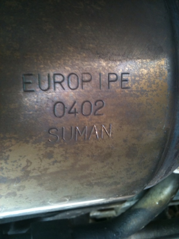

Dr_jitsu ,
I don't know who FLpaindoc is so I don't know what exhaust he has.
All our TT exhausts have a serial number on the right side cat , when I know the number I can tell what it is.

FLpaindoc is a jewel in the roughFLpaindoc is a jewel in the roughFLpaindoc is a jewel in the rough
Hope this helps...
Old May 24, 2010 | 03:37 PM
Dr_jitsu's Avatar
Joined: Nov 2006
Posts: 8,083
From: Texas
Rep Power: 673
Dr_jitsu Is a GOD !Dr_jitsu Is a GOD !Dr_jitsu Is a GOD !Dr_jitsu Is a GOD !Dr_jitsu Is a GOD !Dr_jitsu Is a GOD !Dr_jitsu Is a GOD !Dr_jitsu Is a GOD !Dr_jitsu Is a GOD !Dr_jitsu Is a GOD !Dr_jitsu Is a GOD !
WOW, Suman's old exhaust....small world!
