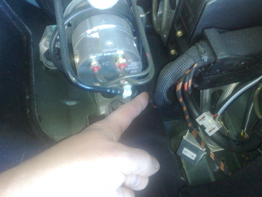

How do you disconnect the PSM pre-charge pump?
Open the front trunk.
On driver's side you have a plastic cowl/cover with a hole for brake fluid and this same plastic cover holds the interior light.
Remove this cover.
Now you see the brake master cylinder and the ABS unit. Next to the ABS unit, kind of under the master cylinder if I recall the stuff there right, there's a cylindrical pump, this is the pre-charge pump. Unplug the power connector (fairly thick black and red cables supply power to this one).
I was about to place a switch inside the car for this cable, just to be able to quickly have some fun with the car and no PSM interference doing so.
There's a photo somewhere around, maybe it was in the "Dangerous brake problem at Nurburgring" thread.

Thanks MrWhite, I'll check this out. My driving is finally starting to cause the PSM intrusion and I want to be free of it.

Here are the pictures
Thanks for the pics SpeedFreak
