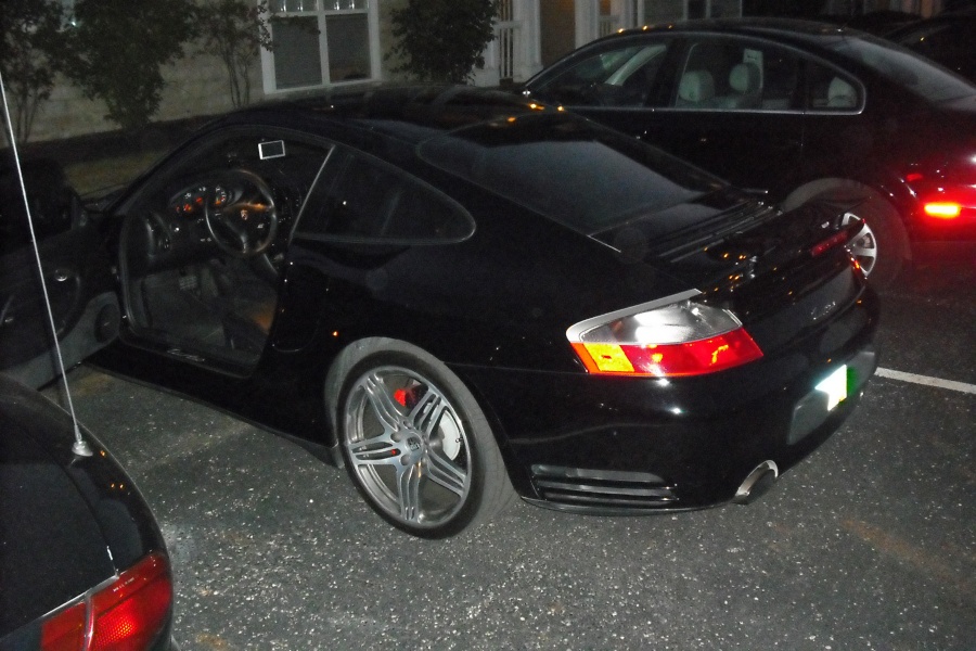

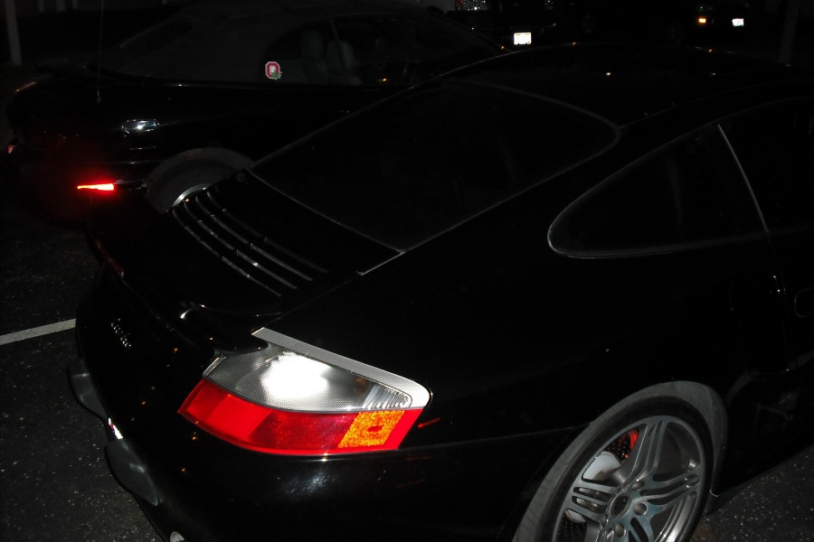

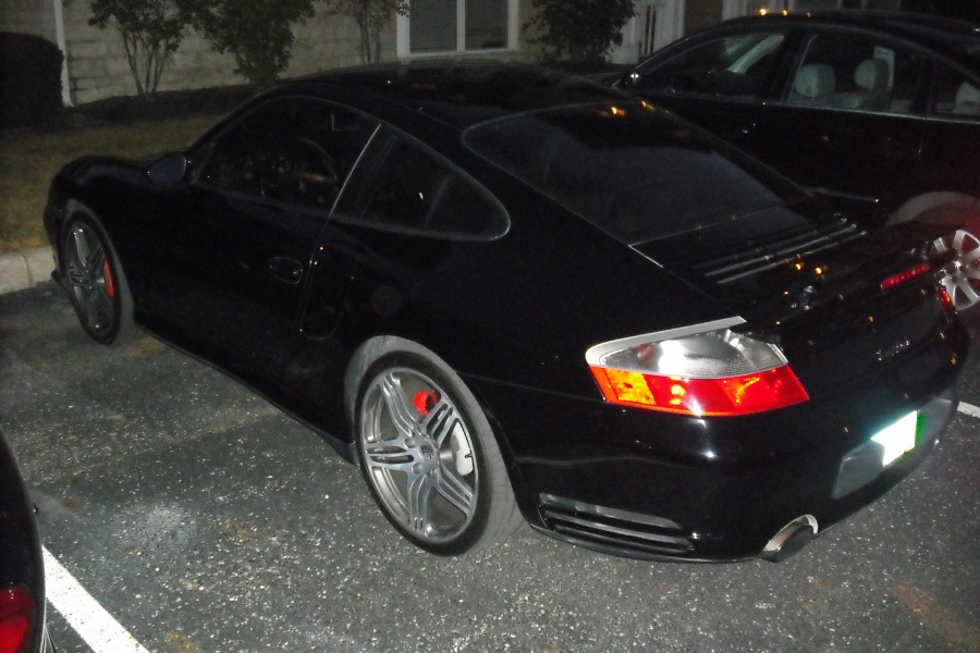

I removed the ugly rear windshield wiper; the car looks much cleaner without it, and I think you notice that classic 911 shape even more without that ugly thing sticking up. The plug cost $42 shipped and came with instructions (feel free to PM me if you want to know where I got it; I don't think I'm allowed to post that info?) The process took about 25-30 minutes total, but if I had the right size tools, you could do it in half the time.
Sorry for the night pics, I can take pics tomorrow in the daylight if anyone wants them. I think this $42 mod is definately worth it.
