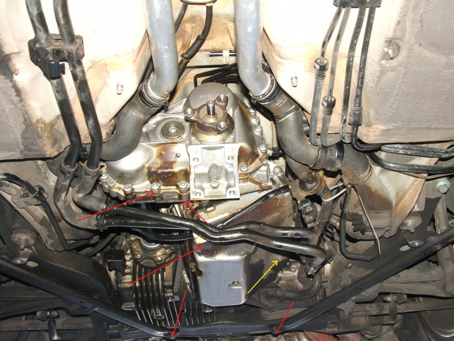

The reason I disassembled mine was to fix a leak. I found the gasket between the rear case and the transmission ripped around the locating pin. I also replaced the rubber "o" rings on the tube between the rear case and the transmission. It will pull out of case pretty easily and it is a good idea to replace them because if they leak you have to tear it all the way back down. I got the torque specs for the case bolts by reasearching like fasteners on the manual gearbox because there is not a shop manual for the TIP. I torqued the gear retention bolts to 50 Nm and the case bolts to 25 Nm(in three steps 10, 15 then 25). It took 2.5 Liters of trans fluid to top it off. Yours will probably take less due to the fact mine was leaking. I have put about 3k miles on it since and no leaks and no gear noise. The only Parts blow out is in the PET with no part numbers given for most of the internals.

I fabricated a fill tool using 1/4 od steel brake line bent in a small radius 170 degree bend with flare fitting hooked up to suction/fill tool. You have to monitor fluid temp while filling it has to be between 30-40 deg C. you can do this one of two ways monitor thru Software(Durametric etc.) or with portable thermometer with remote probe (probe on wire). I did it with portable thermo. I would push a liter into it first then start it up and watch temp when it starts nearing 30c start topping it off till it weeps out.(like filling a differential) if it exceeds 40c shut down and cool for a min because at temps above 40c it will start dumping out the fluid prematurely leading to low fluid level. I then test drove around block and topped it back off there was a slight drop of about half a liter from the trans case being dry.

[quote=MikeyinAZ;2907047]I fabricated a fill tool using 1/4 od steel brake line bent in a small radius 170 degree bend with flare fitting hooked up to suction/fill tool. You have to monitor fluid temp while filling it has to be between 30-40 deg C. you can do this one of two ways monitor thru Software(Durametric etc.) or with portable thermometer with remote probe (probe on wire). I did it with portable thermo. I would push a liter into it first then start it up and watch temp when it starts nearing 30c start topping it off till it weeps out.(like filling a differential) if it exceeds 40c shut down and cool for a min because at temps above 40c it will start dumping out the fluid prematurely leading to low fluid level. I then test drove around block and topped it back off there was a slight drop of about half a liter from the trans case being dry.[/quote

It is actuall not that difficult (to top it off) A complete change would not be fun at all.
The bend in the tubing is so you can get into fill port there is a plastic baffle just inside and the bend allows you to get in (like factory tool) and you can just hang fill tube there and use both hands on suction/fill tool. The attached picture shows the fill port (yellow arrow) and the red arrows was where all the fluid was dripping.
