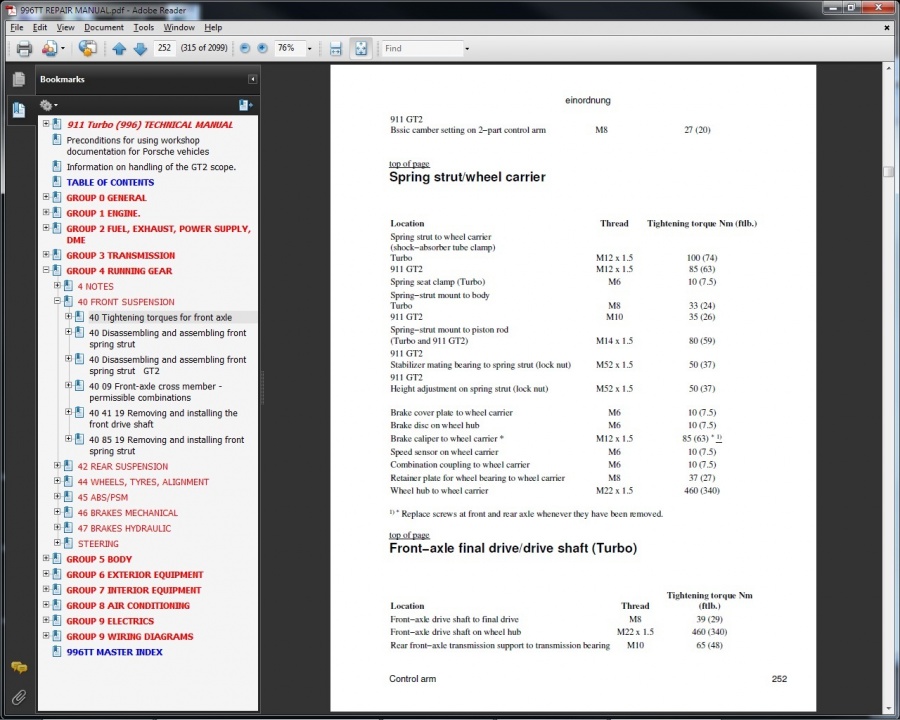

Front suspension specs attached. It's 24 ft lbs.
Jeremy

think you better take it back and have the front alignment checked if they forget to tighten down the shock towers

Seconded. If they were not snug at all, then it's guaranteed that the struts moved. Those mounts receive some of the cornering load. Just turning the wheel can move them.
