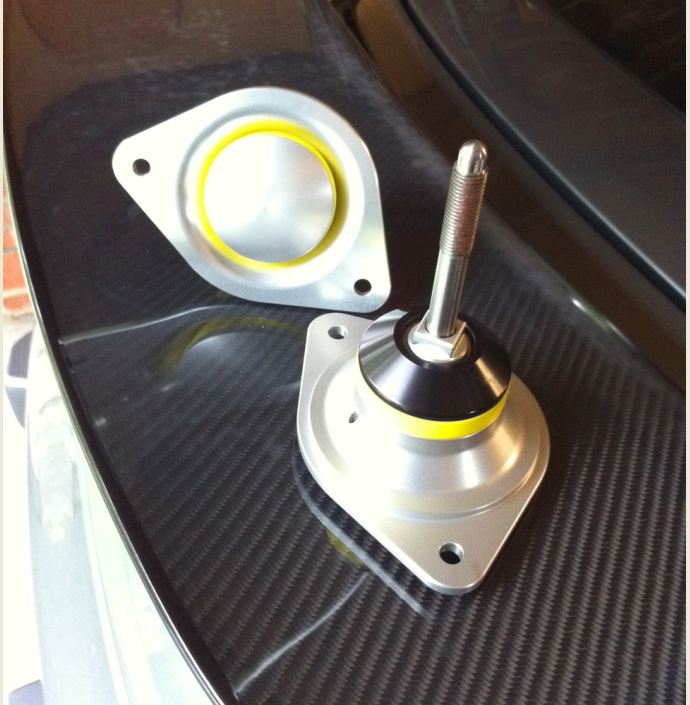

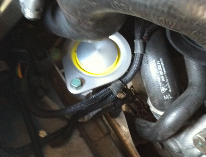

So I replaced my Transmission mount, and both motor mounts last night. Easy DIY on jack stands. I had about a 1/4 movement in my shift *** under load, and sure enough my trans mount was totally shot. I did the WEVO semisolid 997 mounts, and boy what a nice difference. I had not see any pics on here of the 996 - 997 specific mounts so here they are.

Did you replace the trans mount with an upgraded unit fro Wewo as well or another oem piece?

Oh should have said that.. . just the 997 mount from Suncoast. A great use of $200.

How many miles on your car? The ones you removed were original? I have the same year as you with almost 60k now. I'm thinking I need to do this too.

I have about 44k on the car. I have not run the part numbers on the old mounts yet so I dunno what they were.
I replaced the mounts with the WEVO ones as a "while I am working on mounts" type project.
They really stiffen up the car under hard cornering and acceleration.

thx. was the trans mount difficult to change?

The trans mount is just two 16m bolts,2 15m bolts, and 2 15m nuts. Support the transmission with a separate jack so you can raise a lower it to align the mount. I lowered the drive shaft guard as well. If you have a nice selection of wobble and U adapters for the ratchet should take about an hour, alot less on a lift.
