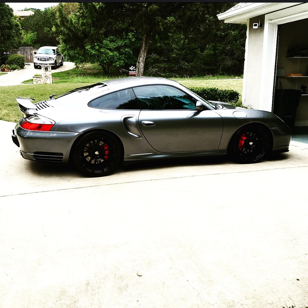

Originally Posted by desiromeo812
Can you tell us what the specs are on these wheels?
For sure, I'll looks for the ET, they are 19x8.5 & 11with 315/25. I'm going to go with the 305/30. I lowered the car a tad so the 30 series will fit just right. I have new wheels coming soon.
