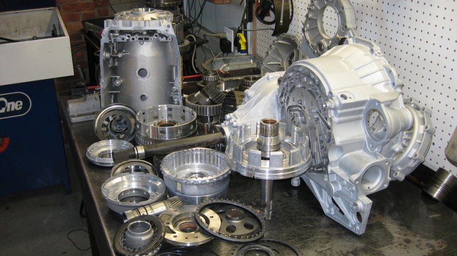

Good timing Dan!
Here are a couple pics from IPT...
I think the first one is of the burned clutches, but they don't look too bad, especially compared to BHT's
The second is of everything disassembled and cleaned up
More pics in the next day or two (new clutches etc...)

Looks like you jumped on it just after it started slipping. Keep the pics coming, I'm curious how the basket looks like that is supposed to be machined.
