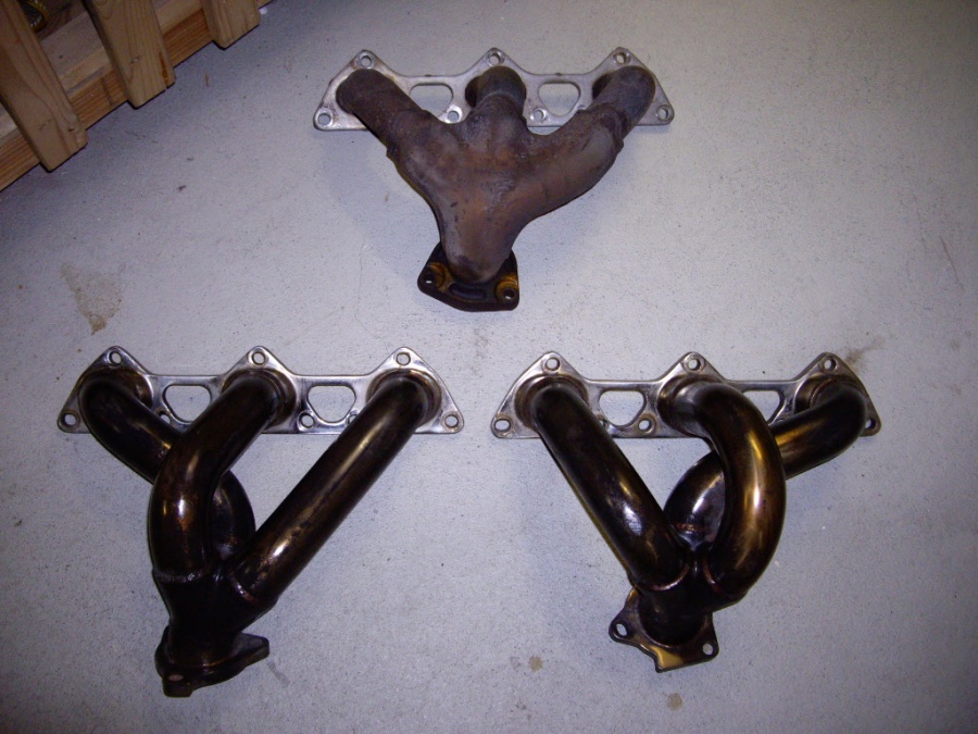

This is what a set of equal length vs OEM TT headers looks like, both available cheaply from me as previously noted

Hey Guys,,I finally took off my original factory exhaust headers to put on a freshly ported set and also to change my cats out...Guess what,,,my 2004 manifolds looked real good,not as bad as the ones you showed in these pictures...Hardly any weld sticking out into the merge collector and the ports only had very few spotted areas in the way.......All in all,I was hoping for them to be bad to justify this swap but I do not know if it was worth it???...I did talk to a couple of coaters,Swain and Calico...they kinda told me that since are headers have short tubes,stainless and being double walled,that there really was no need to coat them for a performance stand point only because the gases are so hot and moving at a very fast rate that they would not cool down enough to hurt regardless..I agree with them...Hope this helps......
