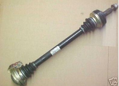

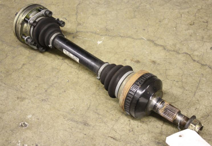

it seems axles are something I should look at....when these break do a lot of things break with it? Should I wait for it to break?

I somewhat remember someone once told me that the axles (or whatever the correct term is) on the Tips are bigger/shorter than 6speeds. If that is true, you should be okay.

Here are pics from an ebay tiptronic axel and 6speed...tiptronic looks much shorter and fatter like you said..
finally the tiptronic has a leg up on something!
