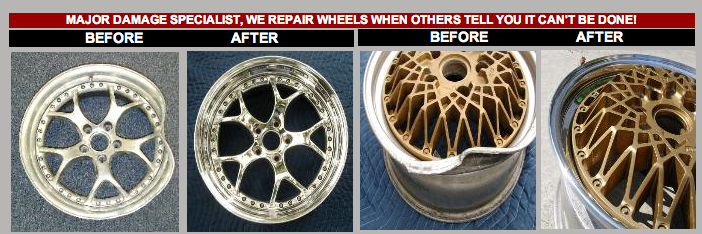

Hey guys, that came RIGHT off their site, http://www.wheeldynamics.com/, catch it before they "CHANGE" the site too. HAHAHAHAAHAHAHAHA LMFAO!!!!!

This wheel failure occurred at the common point of maximum stress in most wheels. The metal breaks because it is overstressed to the point of fatigue. There is simply no way to weld this part and restore its structural integrity. The alloy will still be fatigued, no matter how many times you weld it.
Furthermore, it is impossible to weld such a part with enough penetration to guarantee structural integrity.
Finally, the use of heat in this area, from a source like a welder, is like treating a water leak with a power drill. No matter what you try, the alloy will get weaker and weaker.
Of course, it is possible to create a welded COSMETIC repair, grind off the welding tracks and repaint. This will simply create a time bomb for failure that will be annoying and expensive if one is lucky, and quite tragic if one is not so lucky.
It is our unequivocal recommendation that no repair be even attempted on any wheel, cast or forged, that experiences a failure of this type.
I agree 100%.
That's why i asked.
I would not buy this wheel if i had seen the photo prior to making a deal.

Uninformed wheel shop could have caused some serious injury or deaths if this wheel failure didn't happen they way it did. You can't weld wheels or anything forged(frames,axles ect...)in stress areas, and expect it to hold when put underloads. VeryLucky!!!!

FWIW....on a 3 peice or two piece wheel, or any wheel with a center section forged from 6061 inget, once sheared, that center section is pretty much useless and the molecular lattice structure of the metal upon forging will not regain it's integrity with a welded or otherwise bonded repair.
This said, the rim halves which are spun for the most part ussually (rear barrel and front half on a 3 piece wheel or simply rim section on a 2 peice wheel) can be repaired and are often fixed from things like bends, dents, minor cracks etc...often times one of the advantages of having multi-piece wheels is that these rim sections can be replaced if they are severely damaged. Race teams will do this as well as alter the rim halves for offset and the like.
