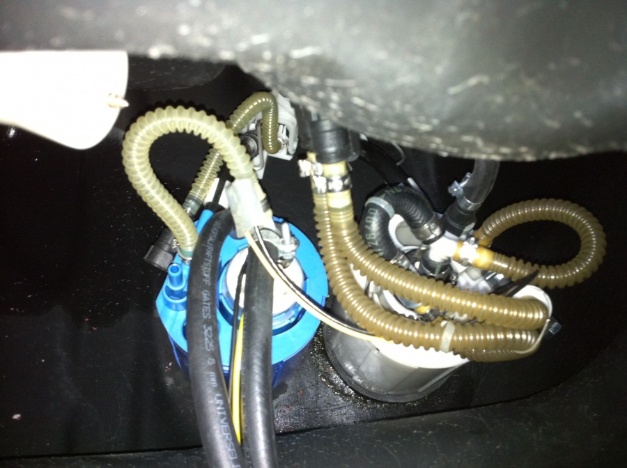

Yes, I do. I put the pump in place of the filter and eliminated the fuel filter altogether. The plan was to use a small in-line filter, but we never got around to it. My tech told me the fuel pump up front is screened with a micron filter and chances are I would not have a problem. So far he's right. It's been fine for 4 years and about 40,000 miles.
You can see it here...

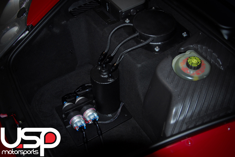

or you can roll with this set-up if you dont mind using the trunk

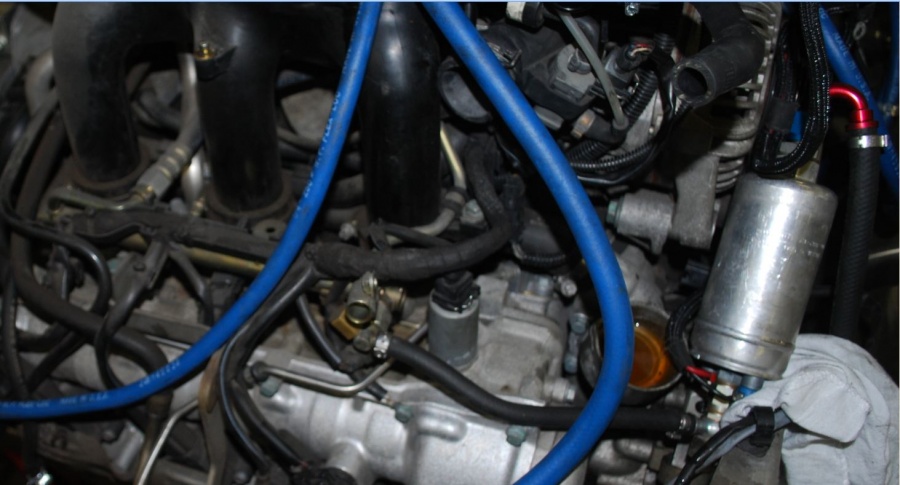

I have a 044 inline. Here is a shot ( engine out ) of the hookup. It mounts into the stock fuel filter location, and uses the factory pump relay for power.
So you're not using the stock fuel filter either? Are you simply relying on the screen filters in the pumps like John @ Speedtech is?
I see you're running 58# injectors... what is the theoretical (hp) limit of your current fuel system?
Thanks!
No fuel filter. I am around 90% DC on the injectors right now @1.3 bar and right at ~600awhp on race.
The 58# injectors were done in 2008, and need to be replaced with 72# if I want to make big numbers. I am actually more concerned with moving my spool down a bit, and hitting full boost earlier. New inlet pipes from markski are incoming!
Tom

tvurt, Change the fitting that connects to the fuel rail. That 90 fitting is super restrictive!
