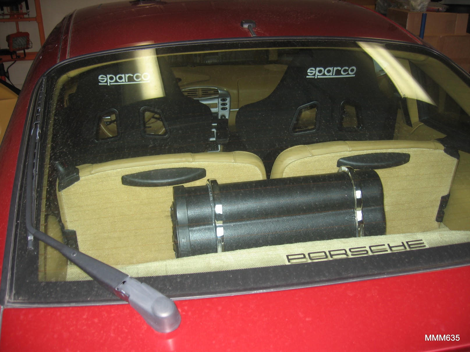

From my past experience with Sirius, nothing is better than mounting it outside of the car which gets a signal from any angle while on the road.
I installed the Sirius antenna for my Kenwood on the rear of the car as seen in the pic below.
