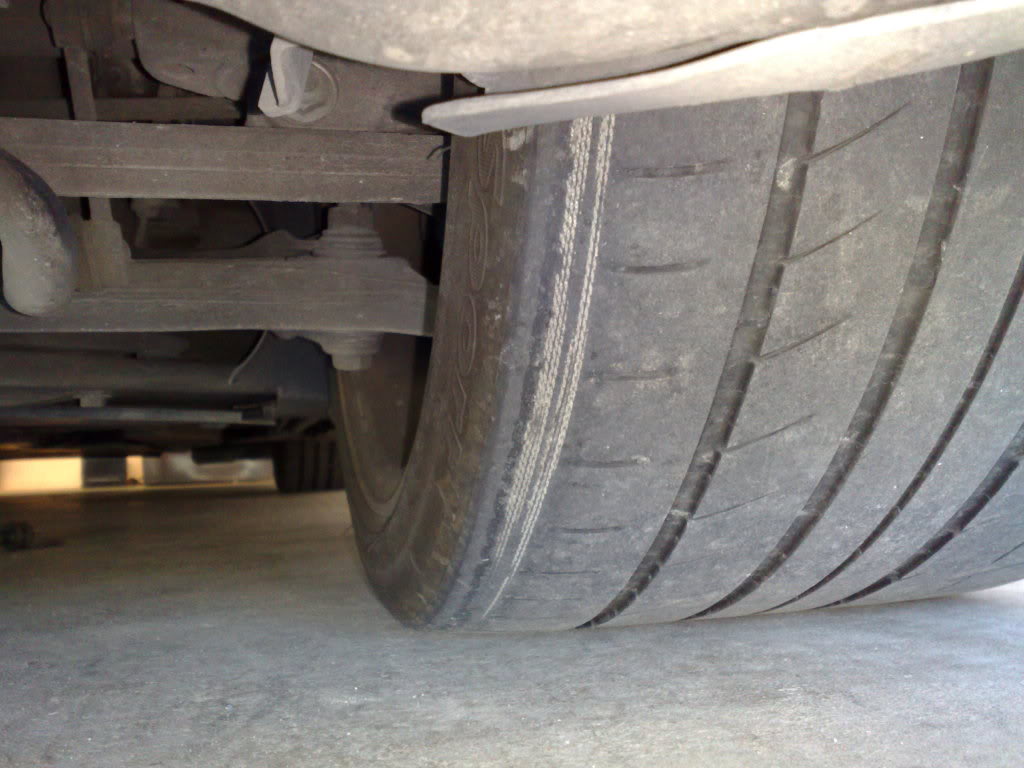

Tire cord showing -question
SubscribeDone it before, but would not advise doing it - it's just not smart.
If you insist on driving, spend $50 and rotate the tires from side to side so the cords are on the outside edge and don't really get into contact with the pavement in straight line or slow cornering.

Since you'd have to unmount the tires from the wheels and remount, and you'd be driving on tires with a reversed inside/outside tread pattern -- I'd say by then you should go ahead and get new cheaper rear tires (e.g. Hankook V12 for $200) that you'd be much better of running on for quite some time.Originally Posted by tvr-4
Done it before, but would not advise doing it - it's just not smart. If you insist on driving, spend $50 and rotate the tires from side to side so the cords are on the outside edge and don't really get into contact with the pavement in straight line or slow cornering.
If you're just trying to get home or hold out until the new tires come in -- you're probably better of just leaving them as is and taking it much easier. I'd suspect no reputable tire place will unmount and remount corded tires for you. Plus I'd be concerned that the stress of that is worse for the tire (?)

Inside/outside doesn't really matter on most directional tires as the pattern & firmness of inside/outside sidewall is the same. The only reason I mentioned this option is because he can't seem to get tires fast enough but wants to drive for e week. Originally Posted by Aerodude
Since you'd have to unmount the tires from the wheels and remount, and you'd be driving on tires with a reversed inside/outside tread pattern -- I'd say by then you should go ahead and get new cheaper rear tires (e.g. Hankook V12 for $200) that you'd be much better of running on for quite some time.If you're just trying to get home or hold out until the new tires come in -- you're probably better of just leaving them as is and taking it much easier. I'd suspect no reputable tire place will unmount and remount corded tires for you. Plus I'd be concerned that the stress of that is worse for the tire (?)
You do bring up a great point of remounting corded tires - now that I think about it, no shop in their right mind would ever do this and risk getting sued.

Good point. Although from the pictures, it looks like the tires in question are PS2s, which I believe are inside/outside (rather than directional) tires. It's confusing because the earlier Pilot Sport Rib tires I have are directional.Originally Posted by tvr-4
Mine were way worse. I was routinely hitting 135 and and felt something funny. When I checked the cords were showing much worse than yours. Needless to say I drove normal after that and got a new set.
I think you'll be okay as well, for short low speed distances. Just keep an eye on them daily until the new rubber comes in. Mine were worst than that when I first noticed the wear. However, it wasn't that much longer before the steel threads/beads broke through. Once I saw that I pulled them off.
Just take them off and reverse them and wear out the other edge
If you are going to ignore cord showing, you can ignore that tire rotation direction arrow too.
Just under the cord you will hit the steel belts which will not just fray apart, they will come out like dreadlocks and go whap, whap, whap in the wheel wells. This audible reminder is much handier than looking at the tread every couple of weeks.
Now, what are your plans to get the next set of years because the ones on order certainly aren't going to last long either.
So raise the car back up some. Unless you have money to burn and rims for free.
Jim

I live in Florida wich is part of the US and our tire laws only apply to highway driving.Originally Posted by Duane996tt
Don't know what the laws are in your country, but in the US that tire is illegal to drive on.
https://www.flrules.org/Gateway/View...sp?id=21176572
