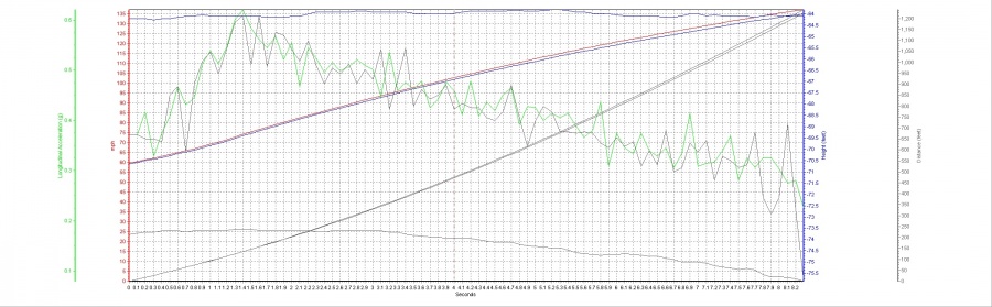

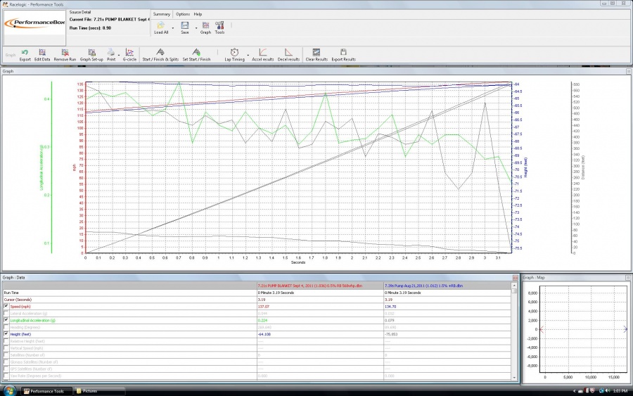

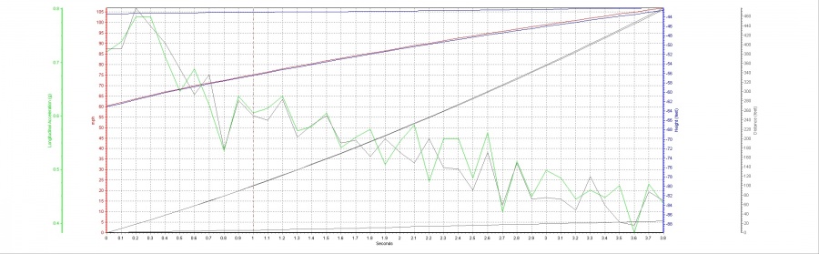

Update: Pump file comparison
As promised, I want to provide additional and ongoing data and impressions on using these blankets.
I have a twin eprom setup from EVOMS. I have a race file and a 93 octane pump file. I have been using the race file thus far for best performance. However, I realize that many of you don't run on race fuel but still may be curious about this mod for your car.
Again, I will use the PBox as the measuring stick. The red speed line and the green g line are the blanketed car and the blue speed line and the black g line are the non-blanketed car.
As you can see by the chart and graph the blanketed car is approx 2.5% faster in a fourth gear 60-130 (7.21s vs. 7.39) These runs were done at essentially identical locations and conditions. The spool advantage is present but is much less than in the race gas runs. The blanketed car just pulls away during the entire run but especially at higher rpms (see enlarged graph).

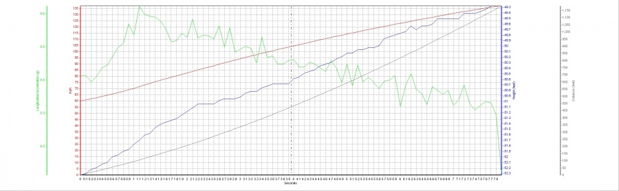

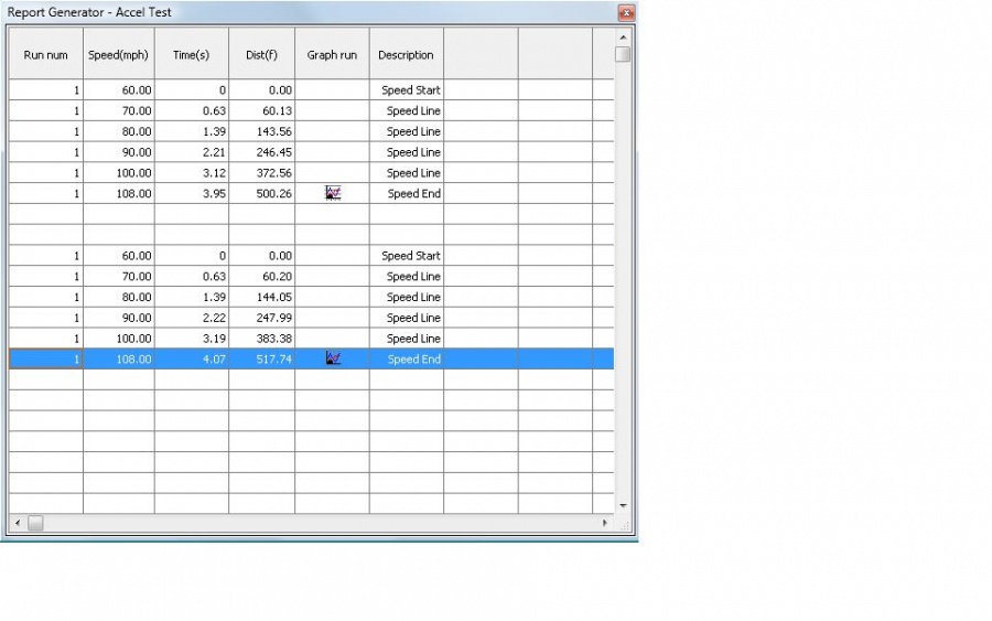

For those of you that are more familiar with third gear pulls. Here are some 60-108 mph pulls with the pump file and blankets vs. no blankets similar to above.
As you can see the blankets pulled consistently harder giving a 60-100 in 3.12s compared to 3.19s. It also continues to out pull it clear to the cut off at 7000 rpm (~108-109 mph).

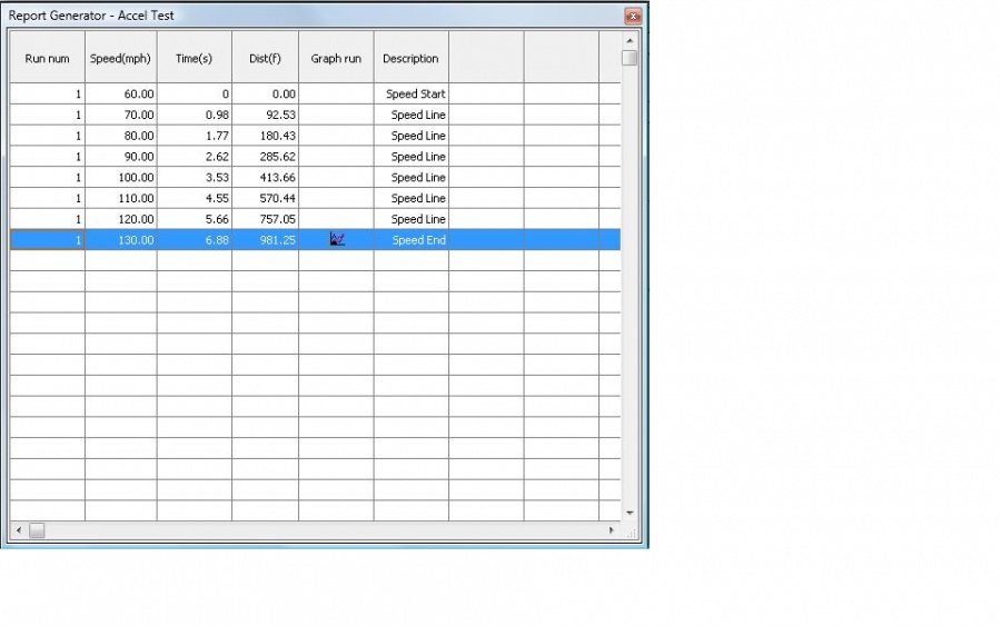

One last addition for tonight.
Last night it was slightly cooler (ie 85F vs 90-95 remember drought and wildfires here). I went out with the pump file because I did not have any race fuel. The car ran a 6.88s 60-130 in warm temps on 93 oct!! Some may not be impressed but for these smallish snails in unfavorable conditions and uphill, that was amazing on pump. Dave conjectured that the blankets may give an increasing advantage as the temps drop. Perhaps he is right. Stay tuned...
