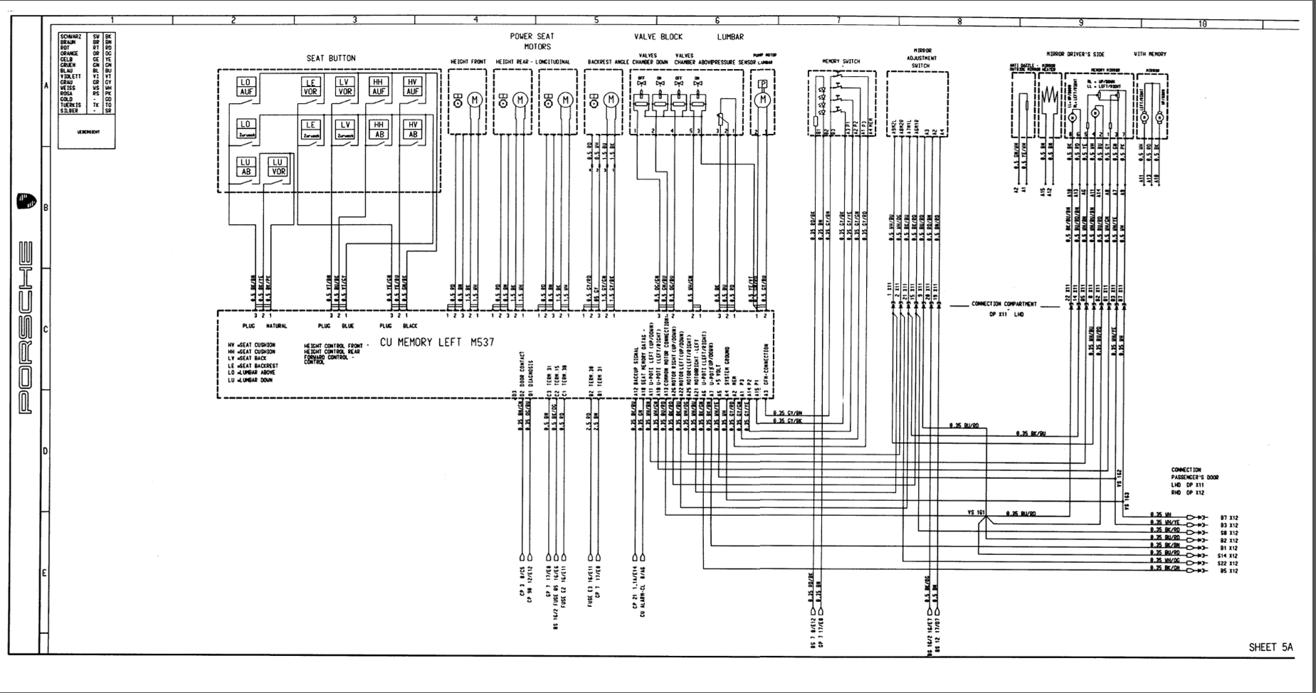

Quick question because I couldn't find the answer and Im trying to avoid taking the seat apart.
My seat/mirror control module went bad so my driver seat doesn't work, Im trying to get it out without taking it apart. I can get to the front screws but need to move it forward to reach the rears. I've searched for the info but can't find an answer but this can't possible be the first time it's happaned. Which of the 4 wire actually run the seat motors?

There are 3 motors under the seat. I think most of the wiring is in the seat too, but you should be able to get the control panel for the seat off while the seat is still in the car. If I remember correctly, there are just two little Philips screws holding it in.
