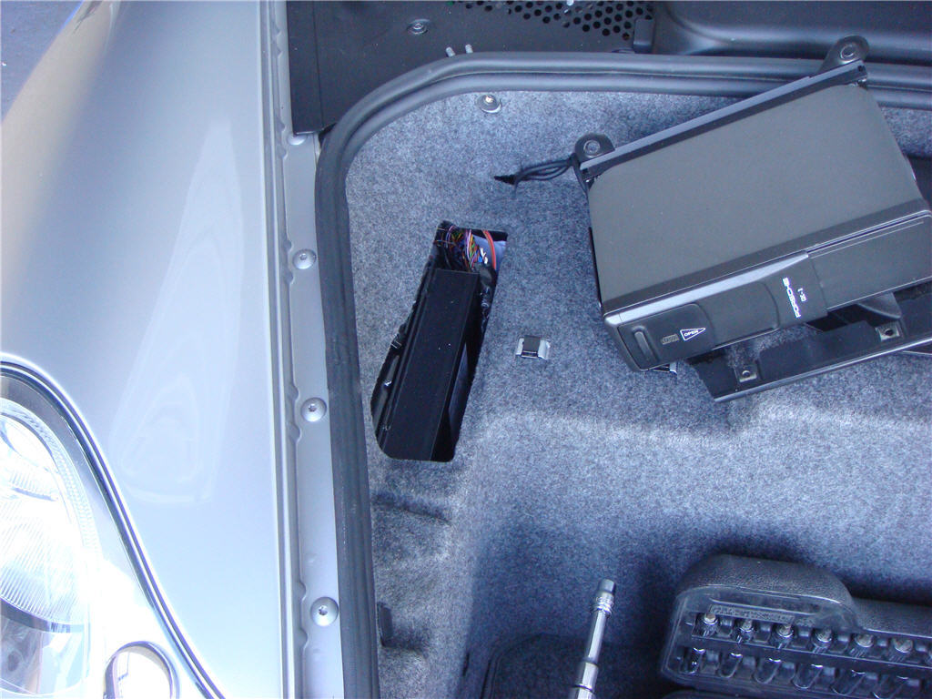

Originally Posted by Kerrage
dumb question whre is the amp located..
It's down that hole on the left...
