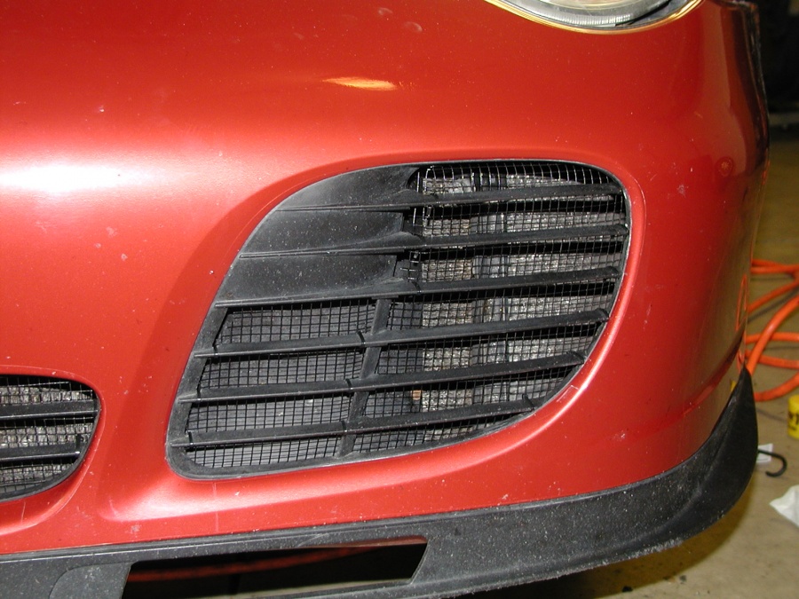

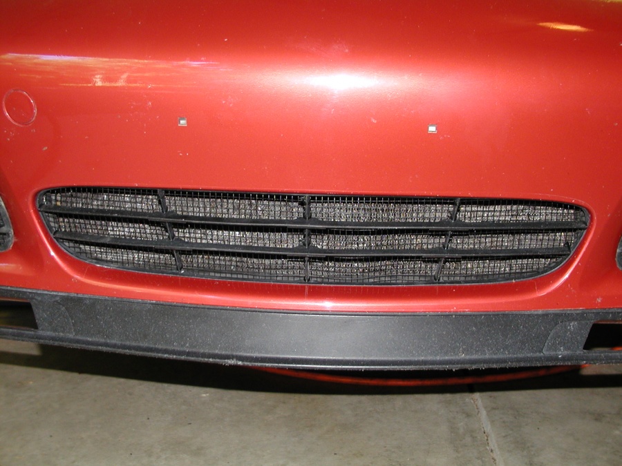

A lot of junk accumulates between the radiator and the condenser. There are just a couple of screws holding them together. It would be nice if you could get that with the shop vac without removing the bumper, but it's not such a big deal to remove it. You should look into putting screens over the inlets.
