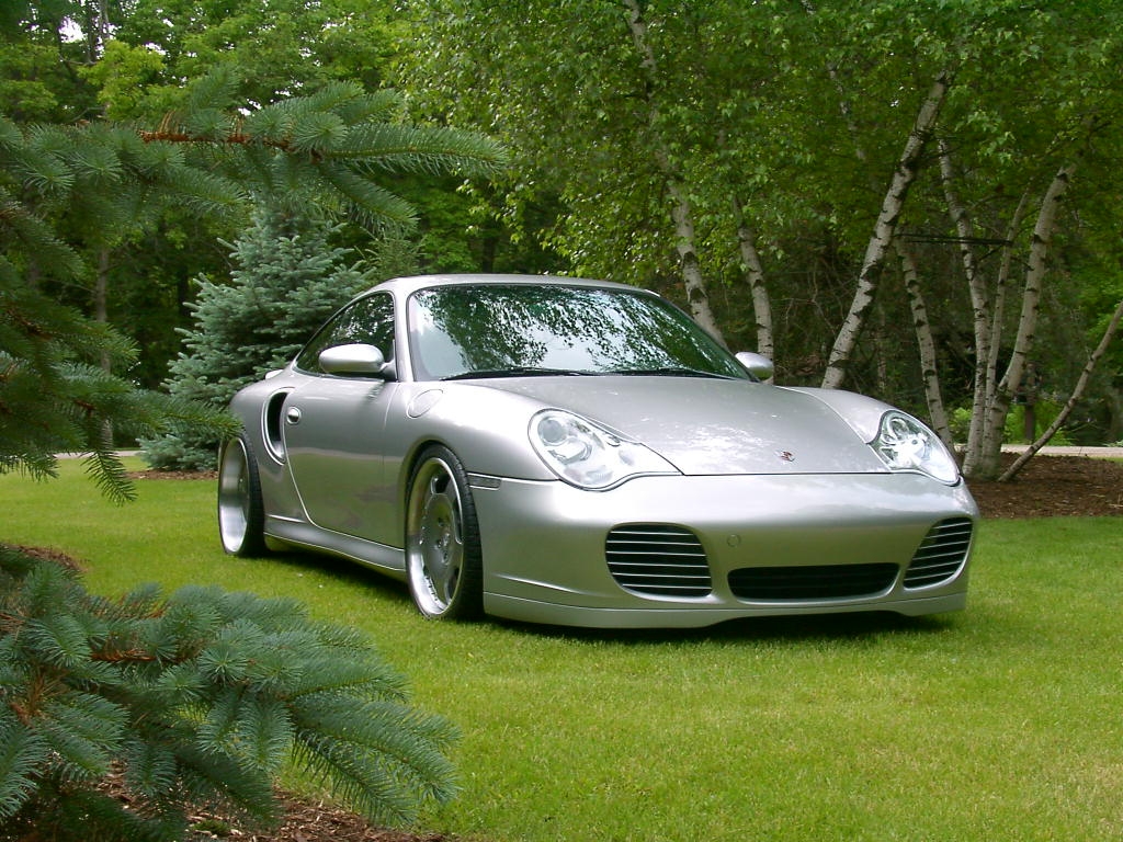

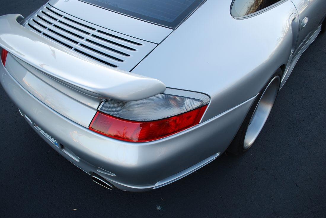

DSCOFF.....if you are really trying to be sure before you pull the trigger, you need to find some good pics of lowered (w/H&R Springs) cars running with 19s.....and find out what their offset and tires are. Plenty of people out there w/H&R springs.....I'd assume most were installed the same (w/H&Rs instructs).
Full discloser....I'm not a fan of 'just springs' mod on a car like the Turbo......but as said, pretty common. So.....you probably have a slightly firmer ride, with limited travel left in the shocks/struts.....but not what I would call a 'tight' suspension (good coil-overs, adjustable sway, more).
I'm doubtful this will help, but I share anyway......here is a car with a very tight suspension, 235s in the front, 315s in the rear (8 1/2J, 11J....42mm/30mm offset) and her front/rear height is 108/120mm which is effectively lower than OE by 50/38mm (which is in the GT3 range).....you can do the inch conversion.
