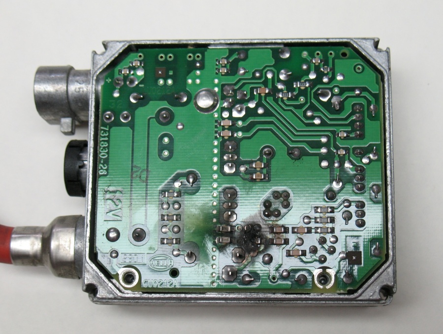

I got this problem twice and it was the litronic control unit. To diagnose, you got a good one, just try it on the side that is at fault. This unit part # 996 631 183 00 is $500.00 but got one on Ebay for $70.00....I was curious and took a look inside the control unit and found a hole in the circuit board....
