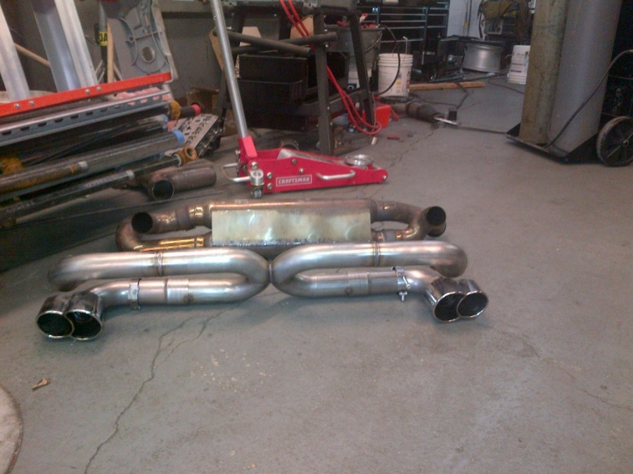

Originally Posted by 9bells
I was looking at that design alot actually, and was not convinced it was worth the effort. I am however curious to know how a system with no x-over but the same length( bends that do not open in the middle) would sound.
I just know straight pipes don't sound good at any rpm. (the straight off the turbo to tip kind)
This design is closer to what I prefer too, I bet it will sound good.
Nice job.
Thanks, I am just messing around. The two banks just need to "talk in order to sound good I did that years ago on my C2 big sound difference. I am not sure which proto exhaust John is referring to but post up a pic here and lets get the ideas flowing. There is no reason why you cant have what you want your way unless its just kills power. lol..

Originally Posted by Tim941NYC
LOL I never liked how all the other exhausts forced the two banks through the same size opening as the primary diameter of the one bank.
Tim
Sending you PM with some info
Protomotives X is like this,,,each pipe comes from each side then crosses each other in the middle then continues to the opposite side to exit..Where they cross,the backside of one pipe is opened and connected to the opened frontside of the other pipe. Both pipes act like seperate in one way but have a common chamber connection. Plus you do not have that sharp U bend and merge hit of gases.

John - I know exactly which Proto design you're talking about
My opinion is that a longer exhaust pipe would be more beneficial, and that ideally where the gases meet/merge they should be flowing in the same direction
However, There is the chance that I'm talking absolute rubbish - It wouldn't be the first time you know
Yes, and this was why I did not go that route. The gases would see each other in opposite directions still.
HI,Maybe I explained wrong??
They never merge at the common opening point of each pipe,I called it a chamber, they still run side by side individually..
I know Todd has made big HP with this system..

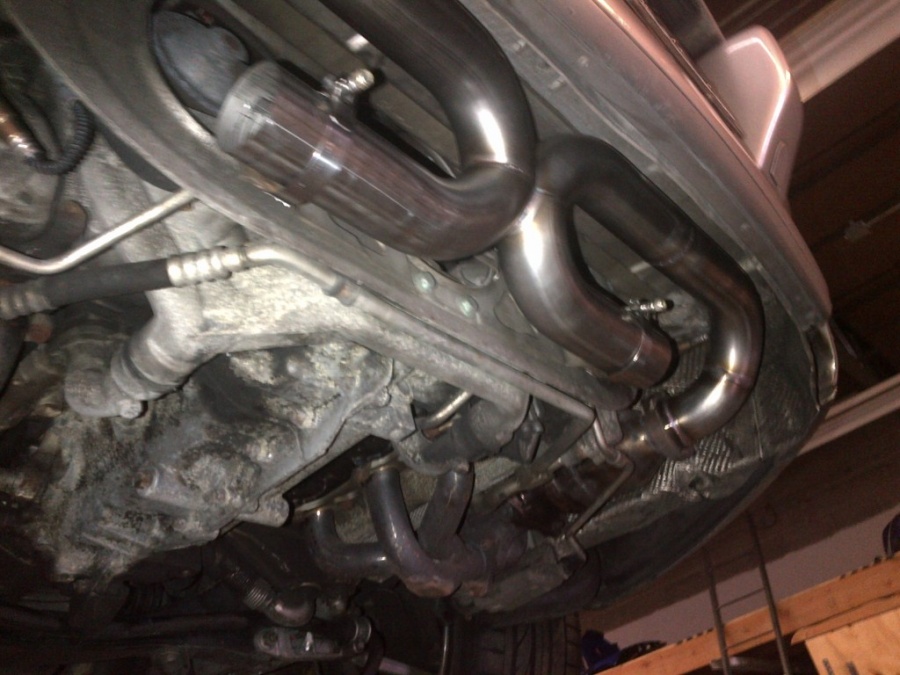

Guys, this exhaust is on my car right now. It sounds absolutely insane. We took a few videos but they were done at 4am, which is when we finished installing the new clutch.
im going to post a thread about it, but for now.. enjoy these pics.
My cats are gutted. I'm not sure what kind of headers i have, but my car sounds like no other turbo i've ever heard.
Tim has a go-pro which we'll put on the car this week.
Thanks for sharing..What size piping ?
Is the bend at the center of the X connected,open to each bank?

DNugget991GT3's Avatar
Joined: Oct 2005
Posts: 5,597
Rep Power: 332
DNugget991GT3 Is a GOD !DNugget991GT3 Is a GOD !DNugget991GT3 Is a GOD !DNugget991GT3 Is a GOD !DNugget991GT3 Is a GOD !DNugget991GT3 Is a GOD !DNugget991GT3 Is a GOD !DNugget991GT3 Is a GOD !DNugget991GT3 Is a GOD !DNugget991GT3 Is a GOD !DNugget991GT3 Is a GOD !
i believe its a 2.5 inch straight through.
as far as the other questions, i have no idea. Tim will have to answer those.
im going to try and get a high quality sound clip. it doesnt sound like two three cyl engines anymore.
oh yea, the car is noticeably quieter at idle.
my fabspeed gen 1 sounded very harley-like at idle (the gen 1 does NOT cross over, its it was essentially a straight pipe exhaust. the idle now sounds like a v6.
John,
I used 2.5 304 stianless. It really is not an X in the sense of the word more like a "window" for the banks to "talk" through.

Hey Tim,You and I have always been on the same page about our thoughts on the exhaust steams of each bank coming together and hitting each other..What were your thoughts on the Protomotive X?
But I do think the EB design is the best design out there in that X type .
I guess most people are more so into the sound aspect ??
