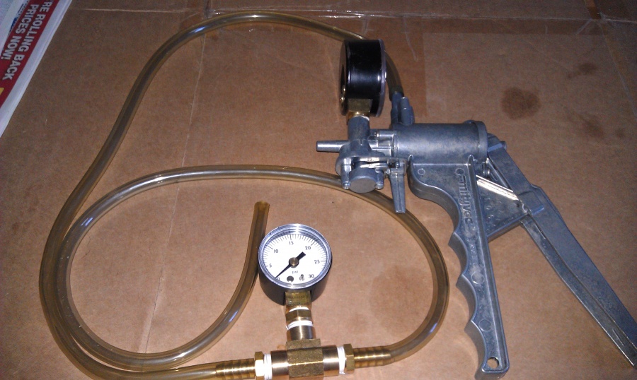

I used this set up with a mity vac silverline. I tested right from the N75 valve to make sure there were no leaks and both WG were opening at the same time.

Thanks everyone! TurboTodd, why two gauges?

The gauge on the mity vac only measures vacuum. I just added an inline pressure gauge.
