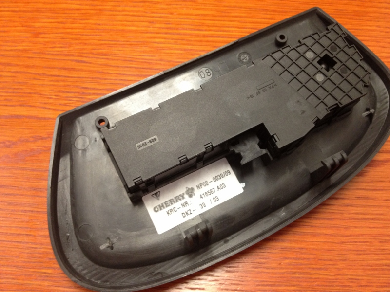

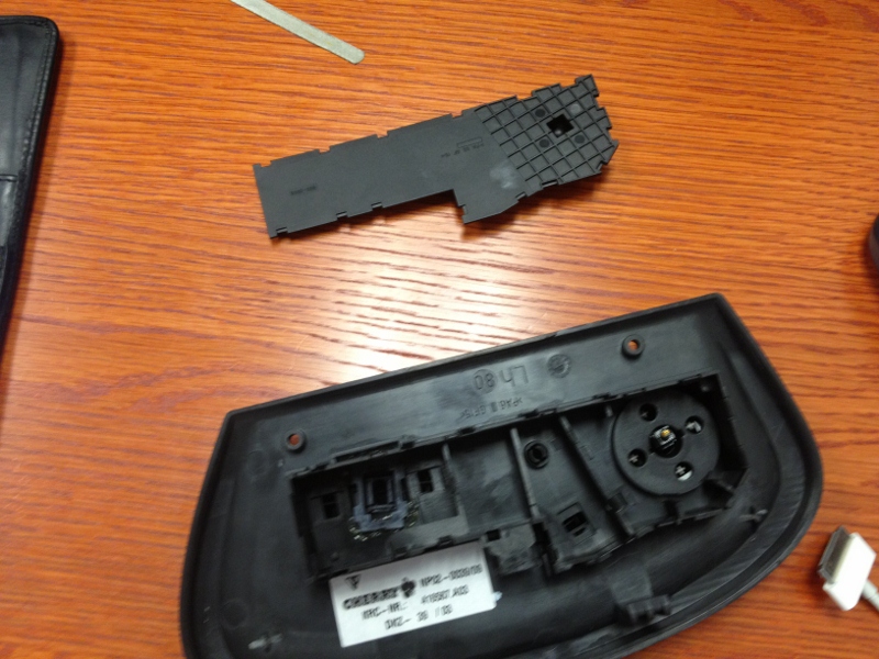

-The "switch" (which we find out later is actually 8 switches) has a back cover.
-Gently pry off this cover, it has 12 or so little finger catches. See picture, the cover is the flat black piece.
-Cut the ty-wrap that holds the cable to the switch body.

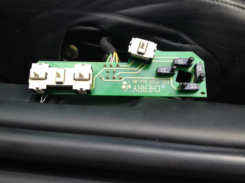

-The circuit board can now be lifted out and from the switch cover.
-See picture of circuit board, still attached to the seat.
Findings: The seat "switch" is really eight little switches soldered to the circuit board. In this configuration you can actually cycle the switches and everything seems to work a little "better" meaning I can move the seat around. Usually.
I was pumped, and then dissapointed, thinking that the plastic toggles that cover the switches had just worn out. Wrong. Seems the circuit board, all on its own, has the same problems...sometimes one but not all work, sometimes none work.
Conclusion so far: It's not the switches or the switch cover. It must be the cable or a loose ground...so no need to actually open up your switch...meaning the DIY just got alot simpler. But....
