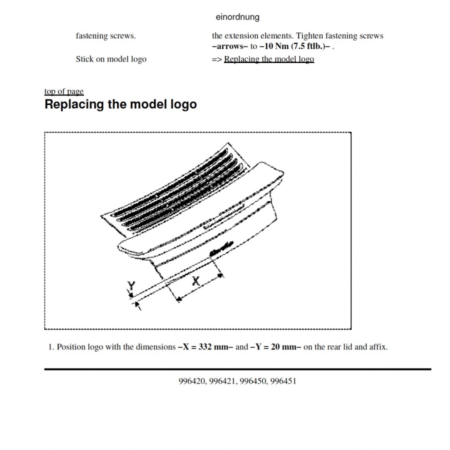

Turbo Emblem Placement
The previous owner removed the Turbo emblem from the rear deck lid to paint it black, but didn't reinstall the emblem before I bought the car.
Does anyone have the correct dimensions for placement, or can someone measure their stock emblem placement?
It would be greatly appreciated.

Yes it is in the repair manual page 893.

Perfect, thanks

Thanks again.
I installed the emblem this yesterday. When I actually looked at the deck lid and measured the emblem placement, I could see a light "shadow" of where the stock emblem had been located. It was exactly align with the above measurements.
It made me feel a lot better that I was getting the emblem reinstalled in the appropriate location.

Good for you Steve. When I found it in the repair manual (yes I have to admit that I've read the repair manual from page one to the end, page 2036..LOL....) I was surprise to see it there with all the measurement!!! Happy to see you got it position properly.
