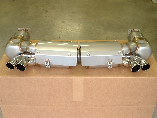

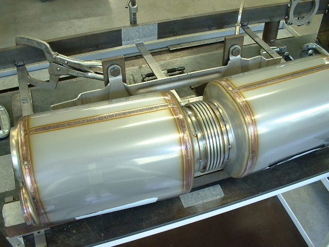

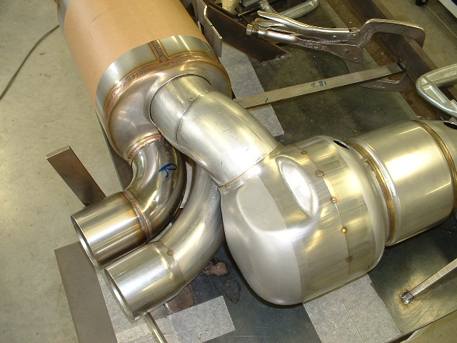

I must preface my comments as follows: I am not an exhaust expert, I do not have 700+ WHP. Stef @ Europipe is a god, and Markski has a huge portfolio of experience with high horse power cars and high quality fabrication.
Thought you might be interested in seeing some pictures of my custom, high flow, EUROPIPE with 997 RSR cats.

that looks great, e-mail sent (Stef)
