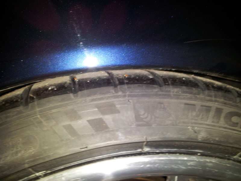

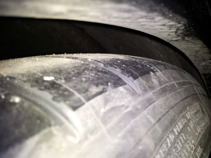

Just put my tires on. Are you guys cutting it this close? I think I may need to roll my rear fenders.

sinKing, where do you have the least clearance? With the 305s in the rear or the 225/40 in the front? Any rubbing after you went for a ride?
My fronts seem totally fine. I don't think there was any rubbing in the rear but it is so close that I think I am going to roll my fenders a little. I also only took it through the neighborhood since I am waiting for a new radiator to arrive.
