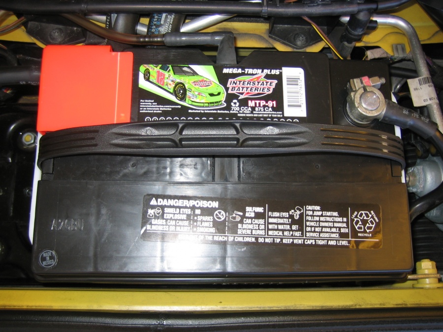

Interstate MTP-91
I recently replaced my stock (I think it was Mobil 1) battery, which was about 14" long and weighed 42 pounds when I removed it! I replaced it with the Interstate MTP-91, which you mention in your original post. Here are the specs on the Interstate:
Product ID: MTP-91
Amps: 875
Cranking Amps: 875
Cold Cranking Amps: 700
Voltage: 12
Termination: A
Weight: 36.7
Width: 6.88
Length: 11.38
Height: 6.88
It weighed about 35 pounds when I installed it (weight savings of 7 pounds using same scale) and is about 3" shorter. It fit perfectly in the stock tray by use of the threaded hole as you can see by the pictures (note the used stock size hole). It also came with a vent tube adapter (had to ask for it though). I just had to shorten the original vent tube a bit. It cost me $132.95 from an independent shop. Interstate customer service number is 888-772-3600. I'm sure they can find a retailer in your area.
I keep it on a trickle charger almost all the time, and so far I am very happy with it. I have had Interstate before on various vehicles and boats with zero issues. I hope that helps.

Did you see post #22? Smaller, lighter, and no modification needed.

Same one that is in my car too, works perfectly fine for cold starts but there is no battery in the Porsche line up that deals these cars when just sitting for more the 2 or three weeks...
