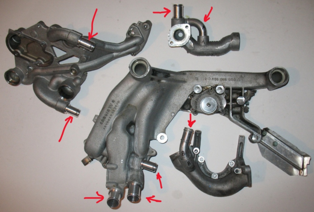

I took out my fittings the other day, and I apparently have 3 large ones and 5 small, when most people have 4 and 4. I called AWD motorsports and they are sending me an additional small one, but is this unusual? My car is a 2001.
Mine are as follows:
Large piece with oil pump: 2 large and 1 small
Oil cooler base has 2 small
Curved piece has 1 large at the end and 1 small

Any pic's? I will look tomorrow.

I dropped the lot off at the welding shop but I do have the old fittings here, I'll see if I can get a pic in a bit.

I got the same set-up, except two are small but curved....

That's it. 2 large on the very bottom of the pic in the large oil pump housing piece, plus 1 more large in the end of the curved piece at the very top. The 5 others are all the smaller pieces. Yet my kit came with 4 and 4?
