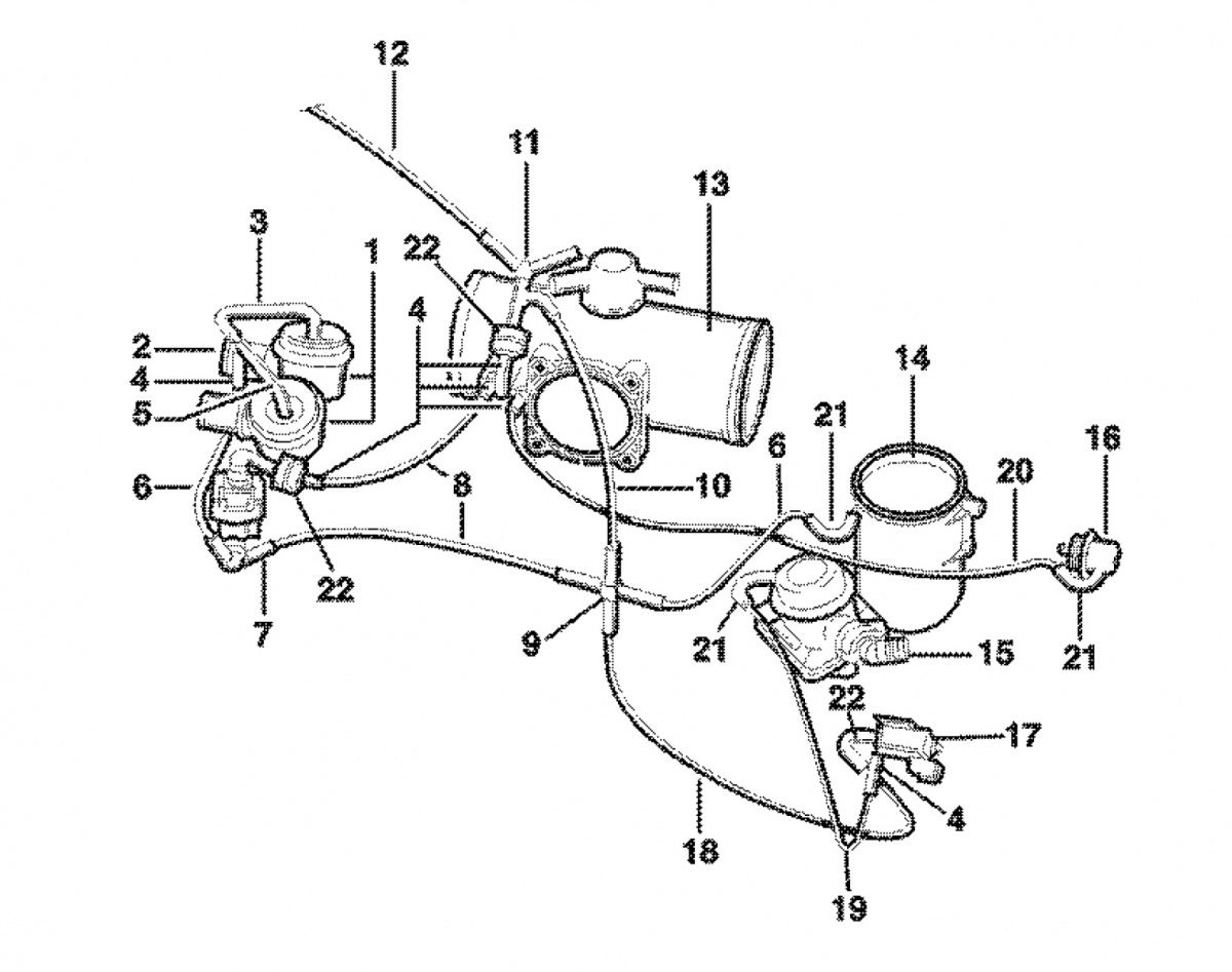

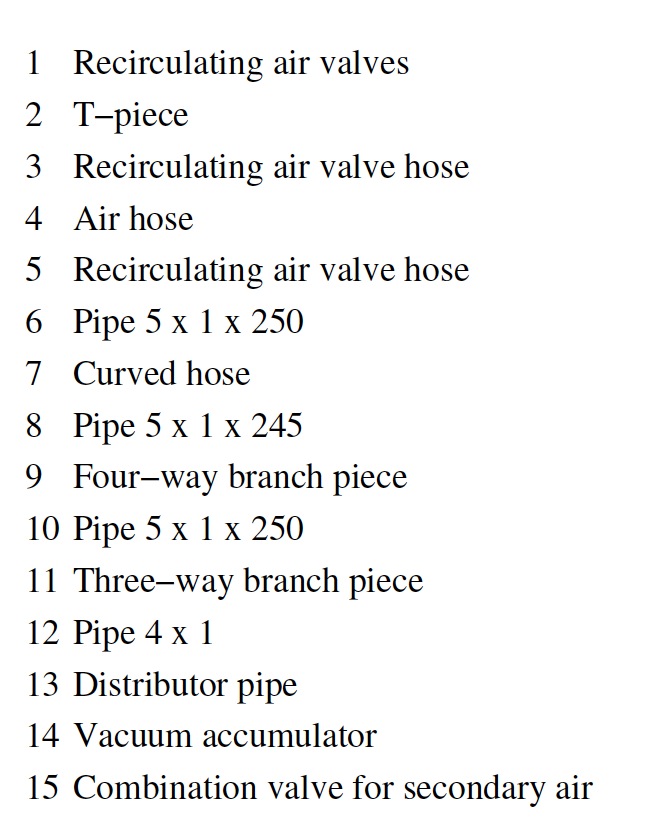

If on cold start you can hear the air pump working for about 5 minutes you should look at a leak or a disconnected sense line. Look especially around item 17 of this sense line drawing.
