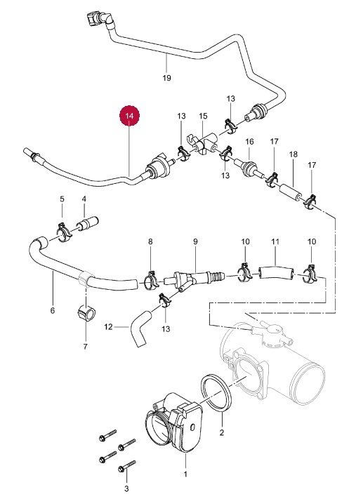

Is this the evap purge valve?
Old Feb 20, 2013 | 02:47 PM
wross996TT's Avatar
Joined: Feb 2005
Posts: 4,660
Rep Power: 254
wross996TT Is a GOD !wross996TT Is a GOD !wross996TT Is a GOD !wross996TT Is a GOD !wross996TT Is a GOD !wross996TT Is a GOD !wross996TT Is a GOD !wross996TT Is a GOD !wross996TT Is a GOD !wross996TT Is a GOD !wross996TT Is a GOD !
Item #6

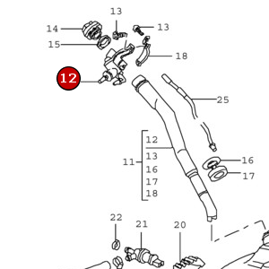

Just to double check .... this one, number #12?
996-201-143-01
Old Feb 22, 2013 | 11:21 AM
wross996TT's Avatar
Joined: Feb 2005
Posts: 4,660
Rep Power: 254
I believe #12 is EVAP Solenoid (Shut off Valve) not the purge valve.

#18? Thats the evap purge valve?
