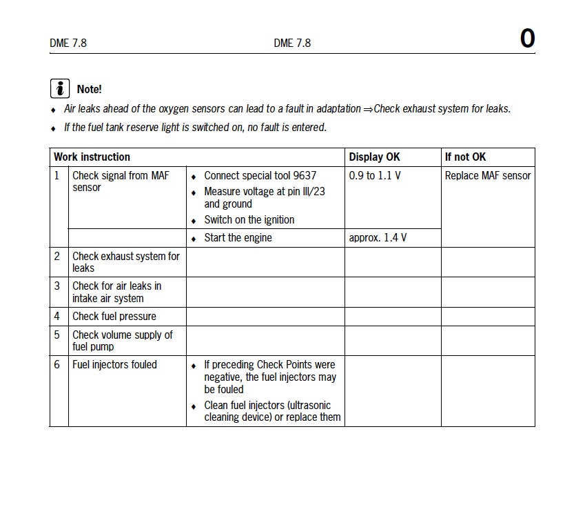

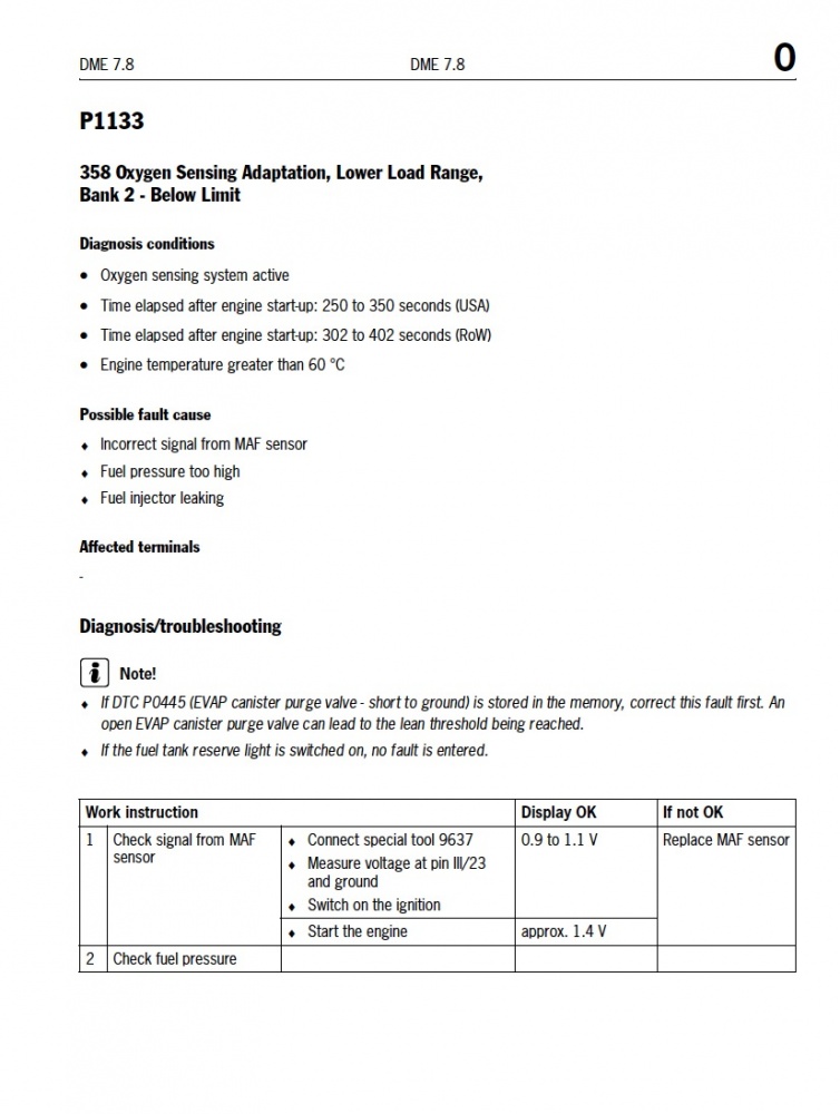

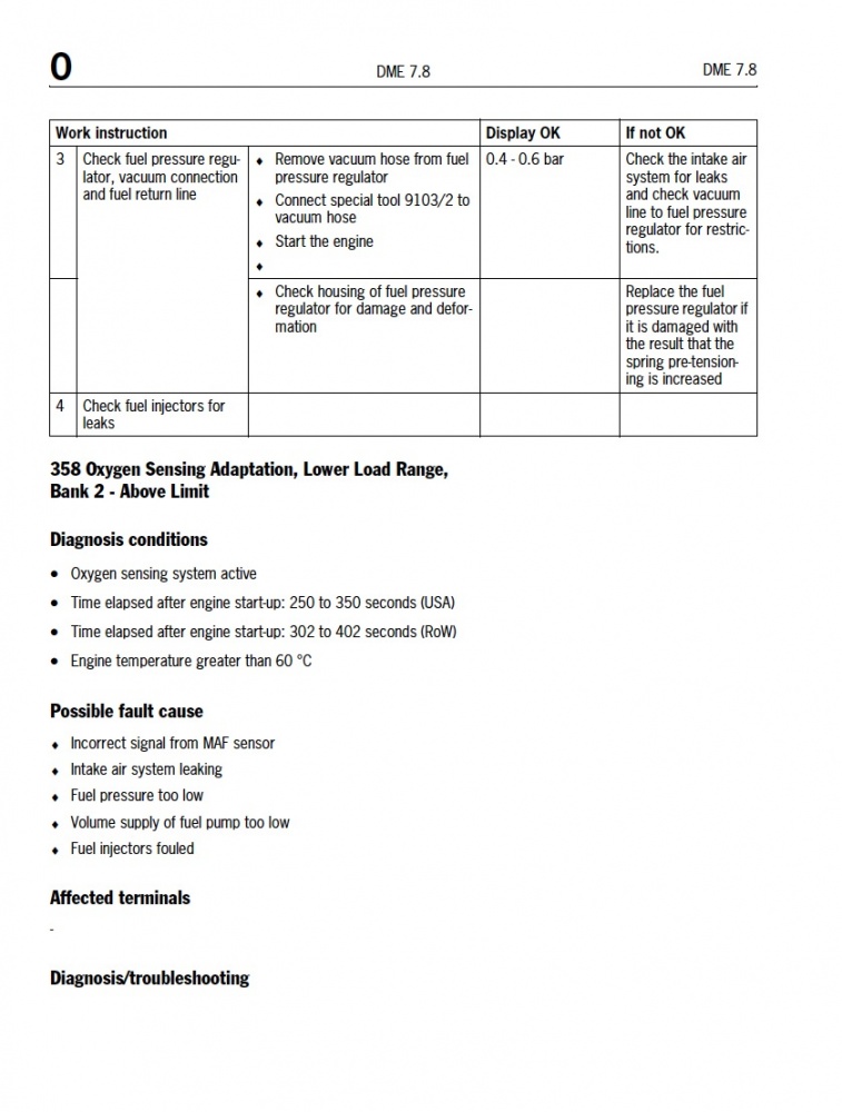

The OBDII manual suggest to test the MAF first for voltage and vacuum hose leak that goes to the fuel pressure regulator. No mention of an oxygen sensor failure....
