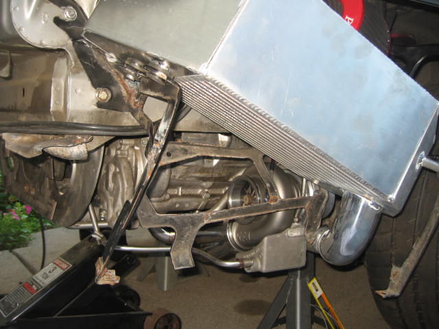

Would an intercooler that size not increase spool time?
Why don't you ask " wouldn't a turbo of that size increase spool time"
Those are gt35rs with .82 exhaust size. Car runs mid 4s 60 to 130, ran 9s, and trapped 119.97 mph in the 1/8th. I believe that's a record on a 996.
As a matter of fact, out 4.5" ics come on faster on stock k16s when compared to stock. I logged it back to back.
The reason I ask "intercooler" is because a larger intercooler increases volume after the turbo which will see pressure. It would seem that would require more time to see full boost than a smaller volume intercooler. Of course you get the benefit of better cooling of the charged air. So where you lose in one end you gain in the other.Originally Posted by MARKSKI@911tuning
Why don't you ask " wouldn't a turbo of that size increase spool time" Those are gt35rs with .82 exhaust size. Car runs mid 4s 60 to 130, ran 9s, and trapped 119.97 mph in the 1/8th. I believe that's a record on a 996.
I want a car that is great in all aspects. I love hitting this local road that will have 8 hair pin turns followed by straights. I need the car to be as close to NA as possible in how responsive and predictable the throttle is. So if the above is correct then a huge intercooler would be improperly sized for my application. It still might be faster in some driving scenarios. I realize that I am going to be leaving something on the table in either responsiveness or top end horsepower and I'm okay with that. I'm looking for the right balance to meet my needs.
