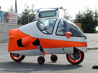

Not relevant to the case. Both the car and bikes rolled off
at high RPMs in a high gear, and the camera man in the car
would have to pivot the camera back as if he was filming a
pedestrian just to keep the bikes in the frame.
Find *another* professional engineer to get a second opinion
on the drag issue. If the task is minimizing drag at high speed,
no one is going to come up with a bike's shape. Here's an idea
though. This is a Super Turbo Mono Ecomobile with a top speed
in excess of 200 MPH with a BMW motorcycle engine. *This* is
what I'm talking about.
Joe

PS: The 'training wheels' retract automatically at 4 mph, and
go flush with the body.
