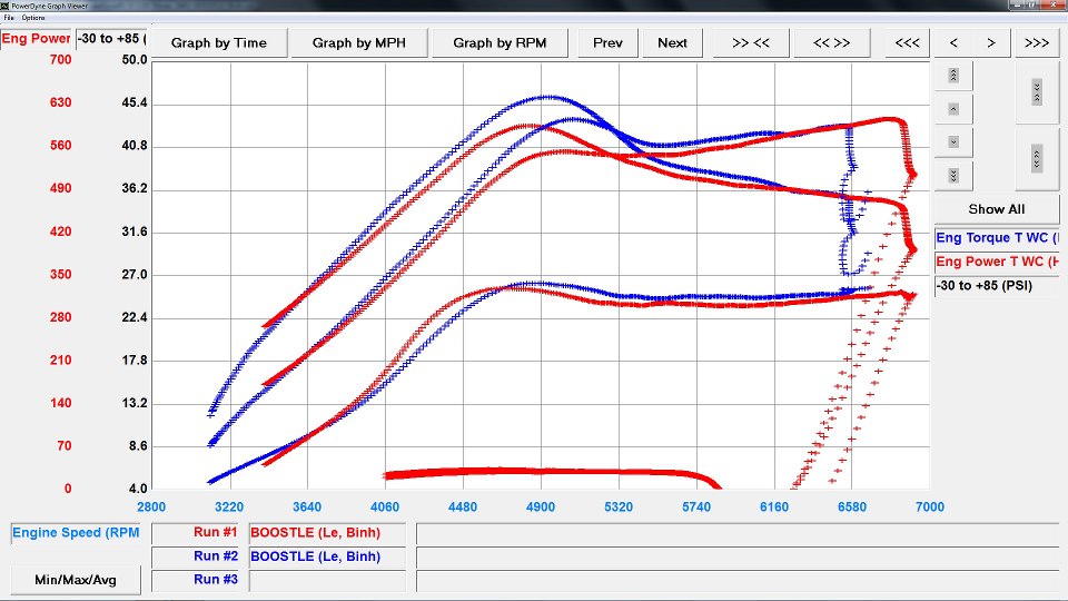

Hi,
I am trying to read the graphs correctly, but could need some help:
Torque and Power bands are not crossing where they should and the torque curve ends a lot earlier than the power curve, which should not happen in a single run.
I would say that both results from a miscalibrated dyno or wrong setup, but maybe you guys where doing something in purpose to the dyno?
I would be glad to hear what the reasons for these symptoms are.
Andreas

You are reading the graph wrong. Blue is hp and tq from one run. Red is hp and tq from another run. Hp and tq cross at about 5250 rpm on both sets. I dont understand what you may be interpreting. Where do you see hp and tq cross?

Ok, I see what you mean. The graph says blue is torque and red is power. I was interpreting it that way and that looks unusual.

I am going to putting on a custom 2.5" y-pipe markski made for me shortly...i am having diverter valves build on each side because I am running alpha 3076s.
Just curious, but why did you go with 3" if you intercooler outlets are 2.5"? Because the plenum and tb are 2.9"?

Also the two, 2.5'', legs of the Y pipe merge will flow more then enough to feed a 2.9 TB opening.
Velocity has its advantage over Volume,,as long as the piping has an adequate diameter to flow enough to begin with and velocity usually gives a better all around flow curve..
Just my opinion here from what I have tested.

I went with 3" because I had a 3" wiggins clamp that I wanted to tie into my tb and plenum that are both 74mm. No other reason really. Now that I am seeing no loss in spool or tq it is all worth it to me. The car feels night and day difference on the street.

How do you know it will "flow more than enough"? Any test data? Vs a 3"? I will never know if my 3" performs less than a 2.5" but I see zero downside compared to the stocker so I will stick with it.
YES their is a mathematical formula just like the one used to build collectors for exhaust pipes, that's what the y - pipe is essentially.
I KNOW from building ones for my race Harley that two 2.5'' pipes going into a 3 '' merge is too small to flow both of those.. When I get home I will look up my math books for formula..
Also many have made big HP on 2.5'' and I believe Speedtech tested both..
I have my stock Y - pipe modified to match my 74mm TB by Protomotive and EVO does it also and runs them.
data ?? nobody got data to share, but everybody likes to ridicule others data and try to poke holes in it.
i'd like to swap my y pipe with yours on the dyno and see what happens since mine is two 2.5" into a single 3". given that we both use the same wiggins and intercoolers it should be pretty easy. only thing is my center runner on the Y is a bit shorter because the 997tt intake puts the TB out further...

The 2.5" legs are standard on all blow thru systems. My 996 made 1000whp on same Y pipe... Proto high end HP cars are all done the same way... However, the center piece of the Y ( long straight) is 3.5" just like on Ben's. That's how we always make them.
