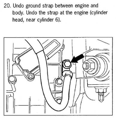

Having thought that the ground strap is the culprit, I connected the alternator case to the airfilter bolt (ground terminal) using 1 jump lead and measured the following voltages. Here are the results:
Measured from a cold start
at the battery 13.0v (same, no change)
at the engine +ve terminal to airfilter bolt 13.3v (same, no change)
engine +ve terminal directly to the jump lead 14.0v (new finding)
*But, as soon as I placed the multimeter on the airfilter bolt again, the voltage goes down to 13.3v again.
So, I tried measuring the engine +ve terminal to alternator case 14.0v
In conclusion, the reading of the voltmeter on the dashboard 13.3v (again, no change)
At last, I unhooked everything and I removed the driver side rear wheel (Right Hand Drive), and looked very hard under the car and I couldnt find the ground strap as shown in the attachment, which is supposed to be near the cyclinder 6 ignition coil. There is a heat shield that stopped me from seeing the 3 ignition coils and the ground strap.
What should I do next?
Would it be a good idea to connect part of the engine case to the ground with 1 jump lead and measure again?
cheers mate

With the car running out your positive meter lead to ground lead at the battery and check for voltage to vehicle ground. I know it sounds weird, but if you have a suspect ground you may see voltage which would indicate a resistance to ground. Keep in mind that often simply reading a ground lead to ground will not show an issue because a ground problem often does not surface until current is higher.
As for your voltage problem, you may have a slipping alternator pulley. Did you replace it with new or use the old one? The pulleys are clutch type that can fail.
Thanks VAGscum for your reply,
Do you mean I should put the +ve lead of my multimeter to the battery negative lead and -ve lead of my multimeter to the car's ground, such as the engine case or alternator case or the car's sub frame or chassis using something like a couple of jump leads and measure the if any voltage exists? If any voltage exists when the engine is at idle, it is saying that the battery ground lead is the culprit.
The pulley in front of the alternator is also brand new, it came with the alternator.
Thank you for your input!
