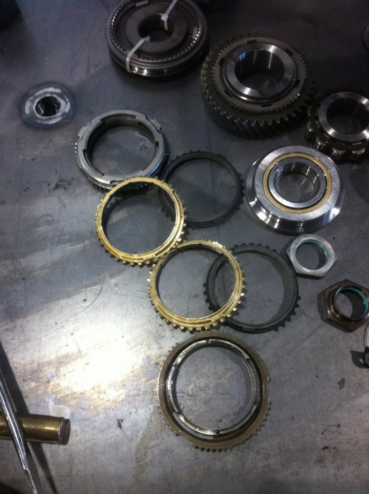

i only had a few worn out parts and this is what it looked like...i was quoted $4,000 until he opened the case..then it became $8,800.
i did used a few upgraded parts, but every little item is very expensive for the these boxes.

it's hard to say what might've inflated the cost from your original estimate? but that sounds like OEM porsche repair, rather than an indie(!) was it. so i wonder if that was oem parts/labor. iirc porsche originally wanted me to commit to the 3k? or so just to open it up, then a determination would be made first as to eventual cost, and second as to which of us would foot the eventual repair bill. fortunately i was able to sway them from their initially defensive and recalcitrant position. i was not to keen on paying that kind of repair money on a recently c'pod car.
scinfidel.. i still think you're at 3500 (ish) 5k tops. don't know if bbi repairs them in house? ( i'll bet you they send em out? ) and if you're getting a decent shake ( read NON OEM ) parts/labor charges.
1st/2nd gears and synchros are max what you should need, provided nothing else has separate issues. some guys go in and add steel gears etc etc. just don't do this anywhere they don't already know about the RESHIMMING. please.
IMA Motorsports in Virginia made the repair. there is a right and wrong way to make every repair and when the labor is about $2,500 to remove and reinstall the gearbox, you should always choose the right way to do it. do not cut corners!!!

i just looked at my bill. the total was $8,700 and i had a trans mount and wheel bearings replaced at the same time and those were unrelated to the trans.
the total cost for the gearbox $7,770.00 . im sorry that i was incorrect before, but to me ..whats the difference between nearly $8k and nearly $9k. it aint cheap.
i spoke to many trans builders to include Brian Copans who is the BEST in the buisness and they were all in the same range for this repair. my shop gave me a lower initial quote, but i ended up at the same number that all of the others quoted.
i wish that i wasnt right about the cost , but you will soon find out that i am...

This is way, way too high to repair 2nd gear pop out. It should be about 2K, 3K tops including OEM parts
