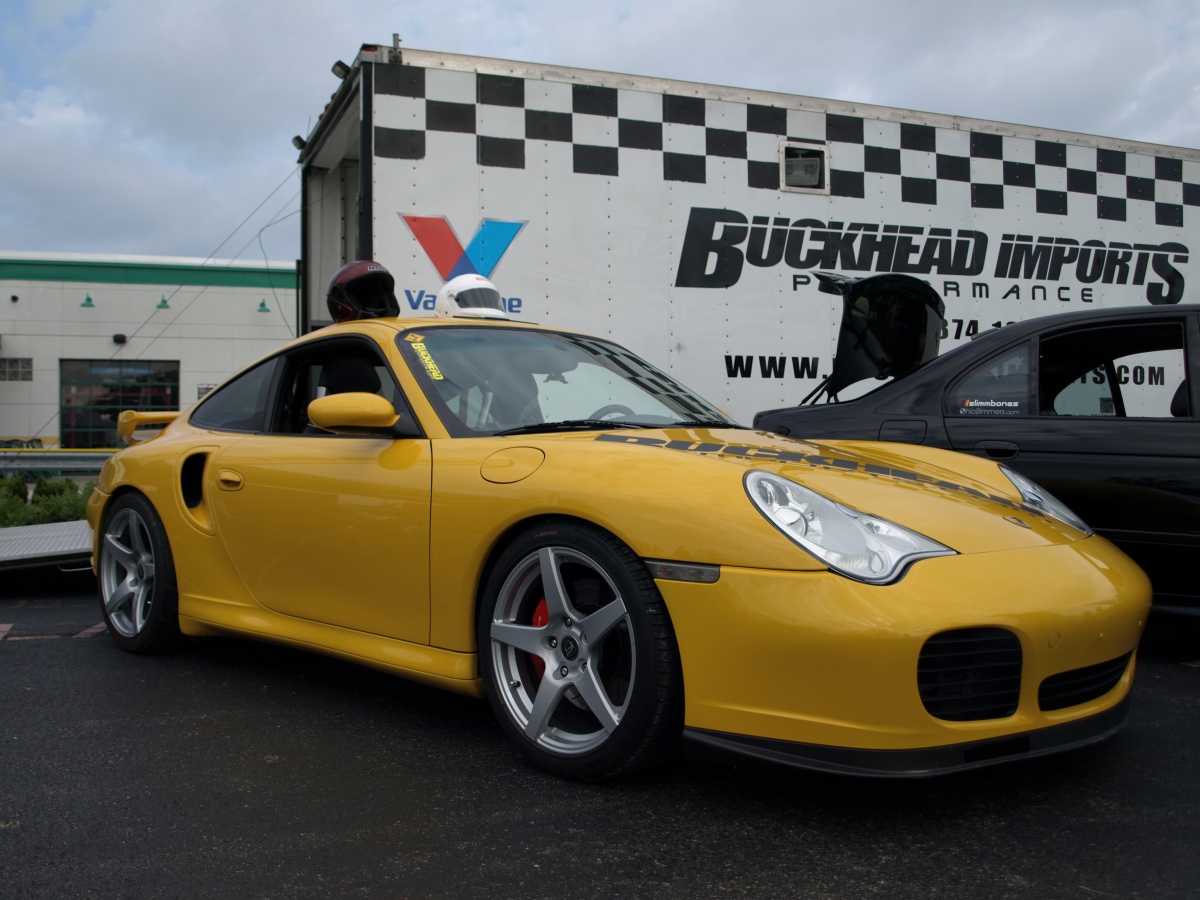

What is the name (if any) of these wheels on my TT?
hey man im really sorry. i didnt realize theyre on your actual car.
i thought you were thinking about getting them and wanted to know what they were called.
sorry for coming off so hard, but trust me , go with a quality wheel. "victor equip" is not something to put on a car like a 911.
the definition of a "QUALITY " wheel doesnt mean they have to be expensive. i have forgestar wheels on mine that are lighter than any of the so called premium wheels and have less than 1400$ SHIPPED for mine.

I am going to keep these on her until I wear out the existing rubber, and hopefully I should be able to figure out (based on the enormous amount of data on this forum) of the wheels I should migrate to. As most people concur the choices are difficult and certainly vary based on preference/opinion...it will certainly be 19" and black or red when the time comes.

he can easily get a set of 997 turbo twists for $1500 all day long. They would look great on his car with some spacers and the right size.
Used (but excellent condition) HRE's, Champions , BBS wheels are all quality.
it's not all about light weight. where is the weight spread ? what is the offset of the wheel ? (will my car handle better or worse than stock), how strong are the wheels (is my entire wheel forged, or just a section ? was it x-rayed ? Have i reminded myself i drive a 911 that puts A TREMENDOUS amount of pressure on the hub of a wheel at low speed turns.
i agree that prices of some of these wheels are sky high . the magnesium wheels (pictured in my avatar) retail for $12000 !! someone actually paid that much for them at one point. i scooped them up in the f/s section for $750.
my gt3 rs wheels retailed for $8900 and i paid $2500 for them in perfect condtion (worked a deal when buying the car with the previous owner).
you can find a great deal on a high quality wheel if you look.
wheels and tires need to be taken more serious than ANY other mod you do to your car. in an an emergency, on a tight turn, on a pothole... what kind of a wheel are you going to want on your 911 ?
Your $1400 BRAND NEW wheels are that price for a reason. its a plug and play wheel they drill different patterns for different brands. they werent tested like champion tests their wheels. they werent put on a track and ran on multiple courses on multiple cars like GMG. they weren't put to high speed , high braking tests like Ruf does to their cars....
my gt3rs wheels weigh 30 lbs each in the rear. heavy right ? when i compare them to my iforged wheels which weigh 26 lbs rear (same size 19x12 3 piece deep dish), the gt3 wheel is easier to spin. take a porsche wheel. put it in your hand, balance it with your fingers, do the same to a different wheel. you'll feel the difference and have a better understanding of what im talking about
Don't buy into marketing hype and think just because my wheels are light they are great.
btw, my 996 is a stock k24 (503 rwhp) car with a flash and rwd that did 60-130 quicker than your car...
... and turbo twists are quite a bit heavier than your forgestar wheels. how do you explain that ?
In my opinion, forgetar, victor equip, vivid racing, miglia some thing , these brand of wheels are absolutely a mistake to put on our cars. stick with a company that tests their wheels. the same goes for tires. i see some of you guys on here having the nerve to ask about some nonsense $200 yokononsense from tire rack that was really intended for the hot shots with m3's and g35's.

I did a little research on Victor Wheels just to see what they are all about. Appears they are made by TSW who's a pretty large wheel manufacturer albeit of low cost heavy wheels. http://www.tsw.com/ look down on the right for link to Victor.
Most wheels like this are produced with a method known as gravity casting which is pouring molten aluminum into a mould using gravity to draw the material in. OEM wheels use Low-Pressure casting which means the mould is pressurized which pushes the molten aluminum into the mould making it more dense. There is no real strength problem with gravity cast wheels from a good company like TSW, they will meet the strength requirements however the wheels are a lot heavier than they need to be as a result of having to add enough material to achieve the desired strength rating. Essentially it's the cheapest method of producing wheels and when simply for looks the extra few pounds required to make them strong isn't a factor. A comparable wheel will be many pounds heavier with gravity cast vs. low-pressure cast like OEM wheels.
The scary part is gravity cast wheels that are made with no strength testing like cheap wheels form china. These are wheels that have a pretty high failure rate and the ones you see in pictures that break, scary stuff. With that said lots of guys run them without problems, however I wouldn't be putting them on a 500hp car, lets say that. Cheap gravity cast Rota wheel broken. Pic2, scary stuff (disclaimer: not suggesting this will happen to your victors.. TSW has a good name and been around for a long time. Rota on the other hand, not so much)
Then you have Forged wheels where the aluminum is pressed into a solid block using dies under extreme pressure. As you can imagine this makes the finished wheels super strong and light. This is one of the more expensive manufacturing methods, so these wheels are typically much more expensive. Some wheels are 1 piece forged, some two piece, doesn't really matter, forged is the key word.

....and this is what makes forgestar wheels a decent option for these cars, at a much lower cost of entry that 1pc forged will be. about 75% less per wheel!
and i take it back. i am shilling for forgestar
