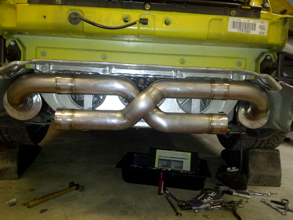

I originally was installing the exhaust system with the bumper and all heat shielding in place. Once I knew there were clearance issues I pulled the bumper as I was informed that some guys flip that aluminum panel over. Well that's what did but it is just not that simple as on each end there is a bulge that would normally go down. So I did some reshaping and trimming of that panel to make it look like it is suppose to go that way. As it is a formed panel with some ridges it takes some sneaky shaping but now it still looks pretty well OEM and there is more then enough room, it is very thin Alum so it is not hard to work. See attached pick prior to final shaping.
In the image it is the right basic shape but I cleaned up the overall lines and smoothed things out. The drivers side muffler is drooping a wee bit as it is just hanging on the studs not bolted tight. But you can see how high the pipe goes, originally the Alum shield would have been touching the pipe the whole length.
Not keeping that heat shield on you will find out real quick once you run some hard runs will not be good in hot weather.
Not keeping what heat shield???? I used every shield that was originally on the car and that should be on the car. You must have missed my meaning. I just flipped the one in my picture so it is on the upside of the bolts instead of being under them.
