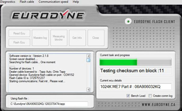

Eurodyne Flash
Eurodyne Flash software package once loaded onto your computer provides the interface that allows the user to:
- flash and reflash the ECU (base file closely matched to your requirements will be provided)
- retrieve and clear fault code
- view measuring blocks
- start logging function
- initiates Powertap Firmware updates
- launch quick tune (some applications)
- activate 2 step (some applications)
- turn emission diagnostics on and off (to be used for off road applications)
- read ECU identification information
- free firmware upgrades as features are added

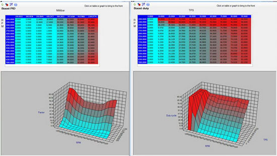

Eurodyne Maestro Editor
Eurodyne Editor is a a complete high speed data logging package that provides graphing and map tracing features and the Maestro map editor. This powerful software package allows access to all relevant maps, scalars and switches inside the ECU binary. Editing wizards are included to speed the implementation of map adjustments. Once edititing is complete file can be saved under a new name the uploaded to your engine controller.
- import data logs and view correction values
- modify values in multiple cells using the stored correction values
- injector wizard capable of modifying appropriate maps when injectors are resized
- view histograms to pinpoint cells used during a specific engine sequence

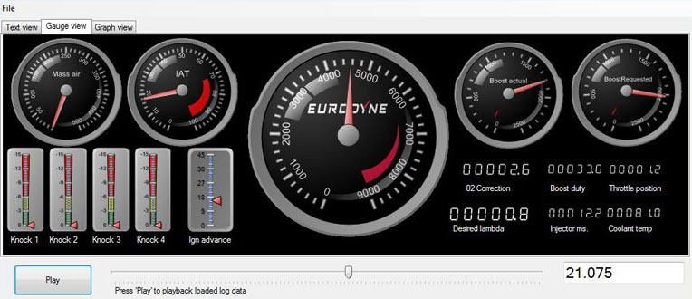

Eurodyne Log Viewer
A graphic interface that interprets and plays back .csv logs recorded using Eurodyne Flash. Log viewer provides three visual display modes and user selectable graph variables. Up to 20 values can be viewed in one of three different modes:
- text view
- gauge view
- graph view
