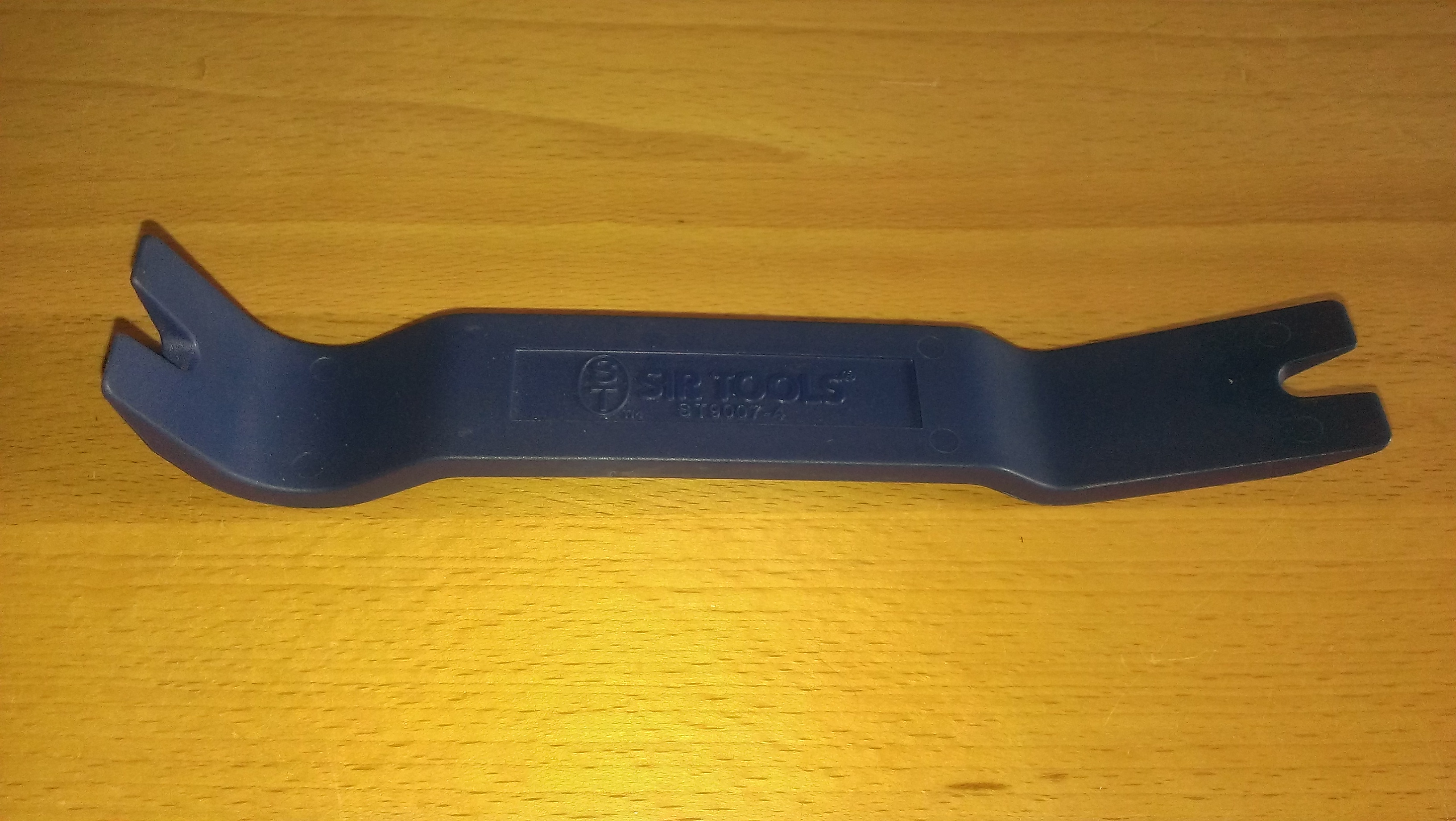

If you are talking about what I think you are talking about.
Use a plastic interior removal tool like pictured. Or very carefully use a standard screw driver. Pry the plastic rivets out and remove.

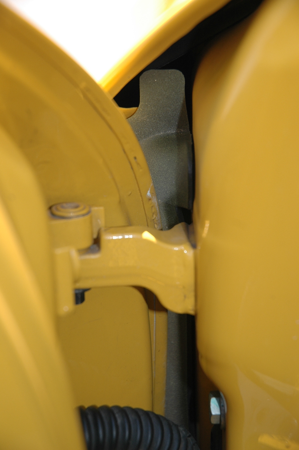

Here are two pics showinf you what I mean. Not the best quality unfortunately.
Thanks again
Luke

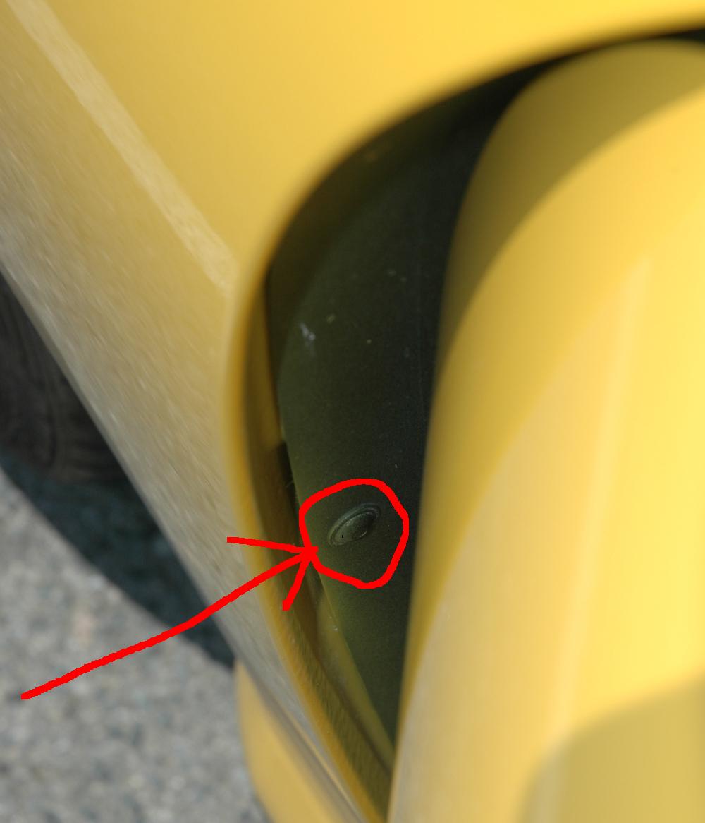

Yep thats what I am talk n bout
Remove the plastic rivets by pressing in the center and prying up on the outside. Once you get one you will know what I mean.

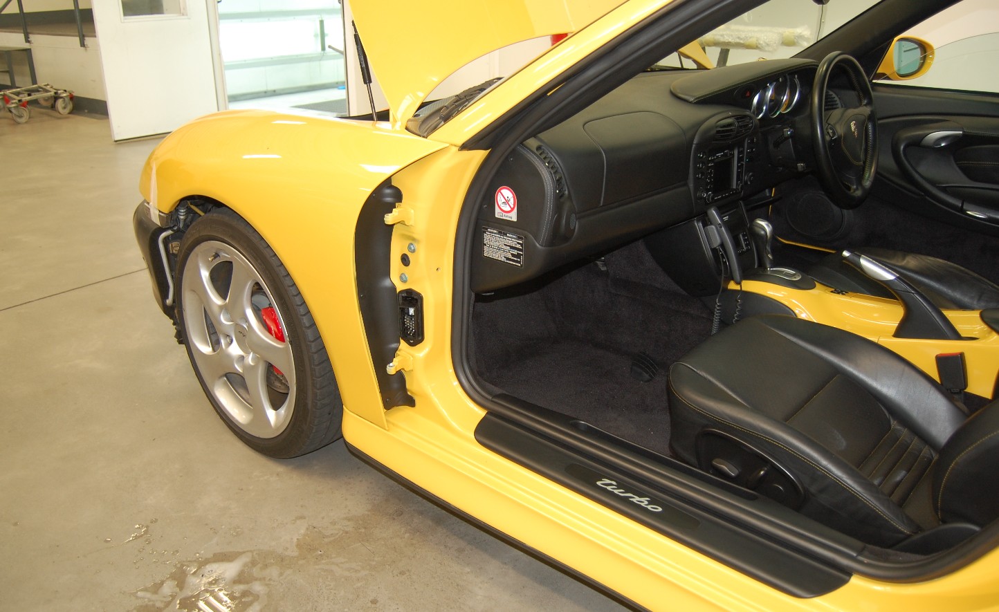

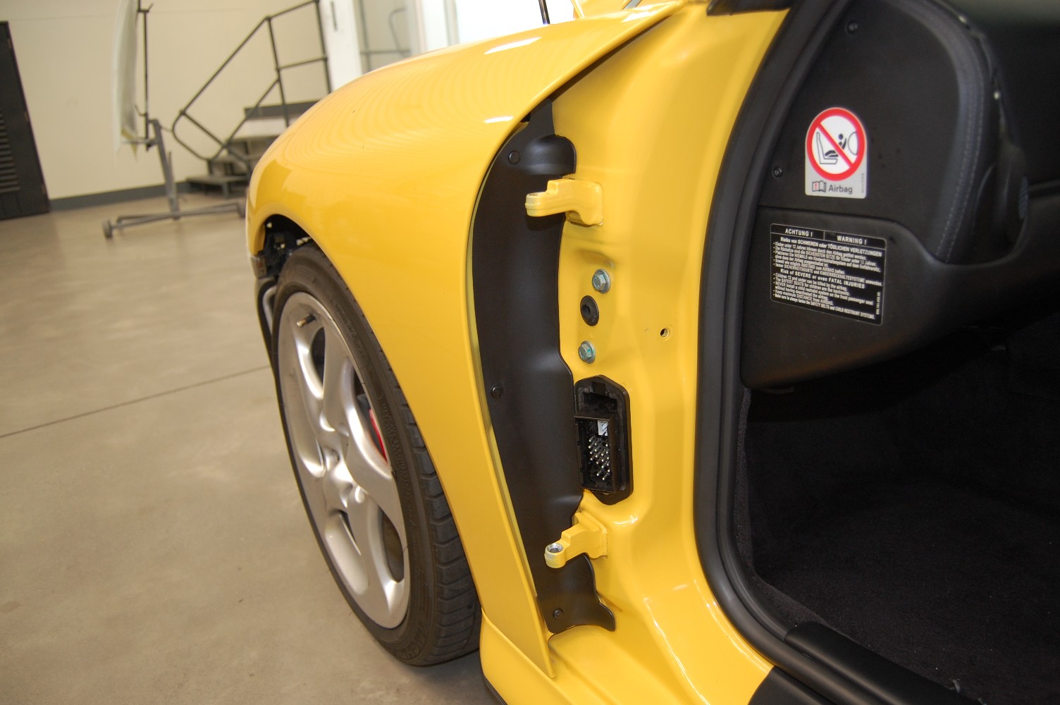

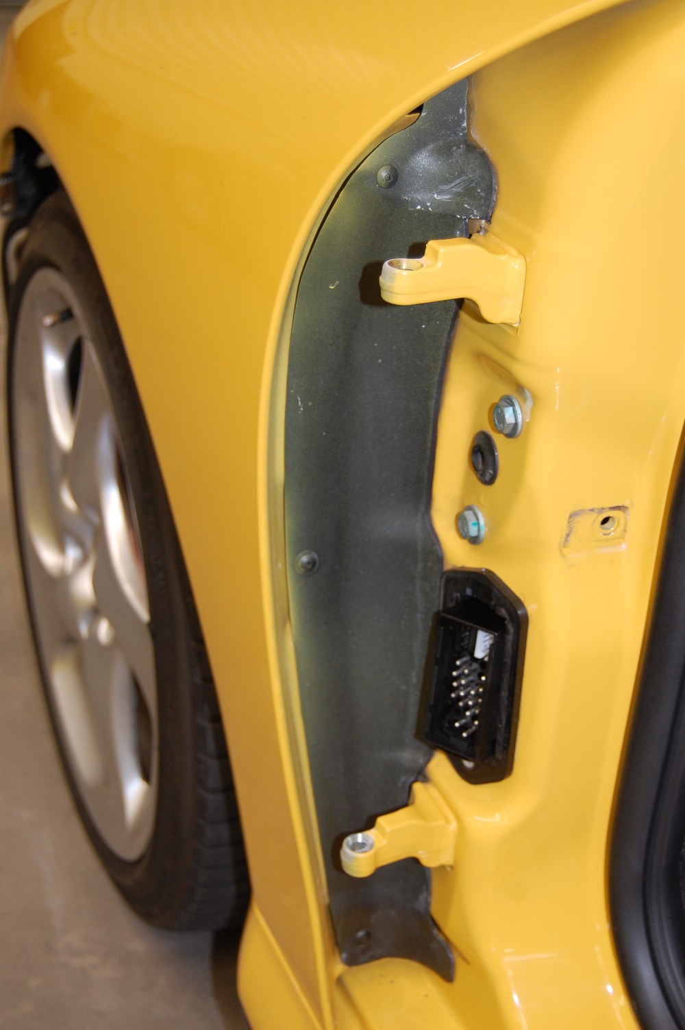

Tried to find this tool with no luck. In the end removed the doors cleaned the plastics and re installed.
Thanks for all the advice.
Here are some pics

Looks good and a lot of work but mission accomplished lol.
