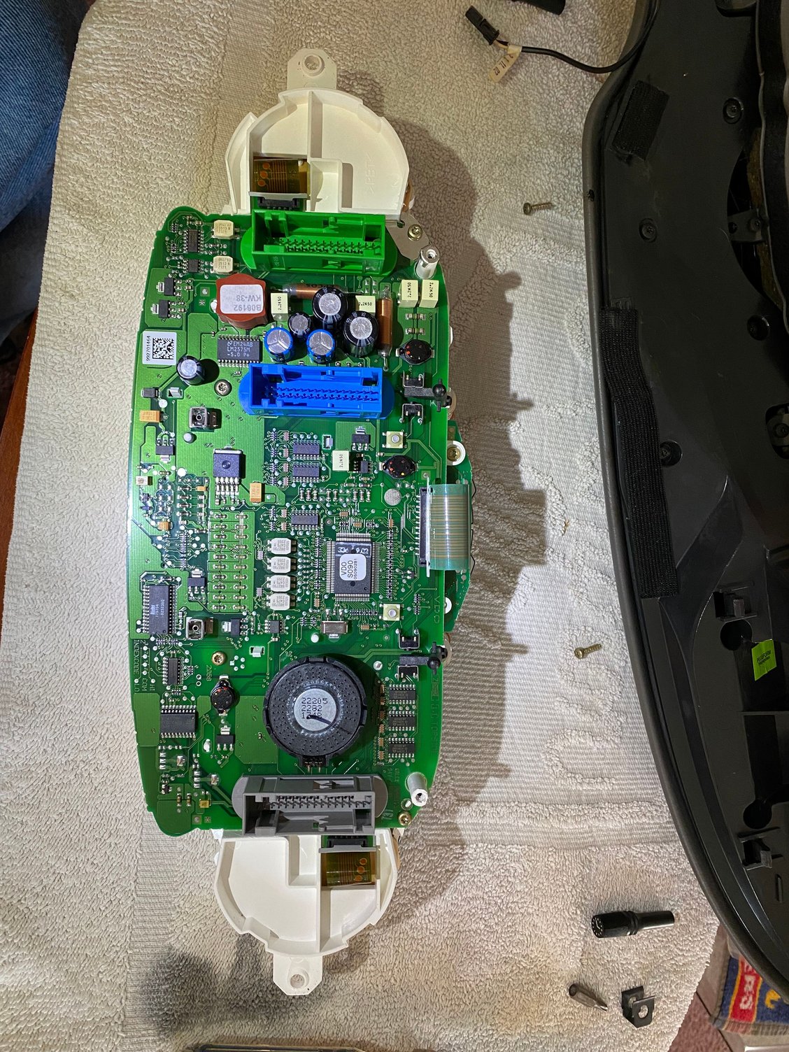

Originally Posted by TXCoaster
The 986 cluster switched from bulbs to LEDs around 2001. Supposedly the 2003 996 and 986 are very similar except the outer two gauges (voltage and oil pressure).
Do you also have white warning indicators for over temp and low fuel? I'll need to take note of those.
Are the filters on the speed and clock just like the AC control amber filter? They'll need to be replaced with a white filter too?
Thanks for the info. I'm building up as much info as I can before I tear into mine since I have very little experience with auto electronics.
The little side LCD screens do need to be replaced with a white filter or you'll get the same color as me... Green... Yellow + White LED = Green? I suppose they have a blue-ish tint... haha
Just mark which LEDS would correspond to what. The only 3 LEDs that I soldered to white and shouldn't have are the blinkers and high beams.

Originally Posted by TabooPc
Hello Everyone!
I've spent a lot of time learning and researching how to execute this project. I'm finally ready to give you all a write-up on this!
I recently changed the gauge faces of my 2003 996 GT2 from the dull orange to a brand new BIGHT WHITE! The results are amazing... I have to share with everyone else.
This guide will cover the disassemble and changing of the LEDs within the HVAC and Gauge Cluster systems on Porsche 996's 2001-2005.
I'll get some better photos of the final result eventually. The LCDs are green because I didn't remove the filter from those. To get the LEDs color on the LCDs I would have had to replace those filters too. This isn't hard, but when I first tested them I liked the green... [/SIZE][/CENTER]
