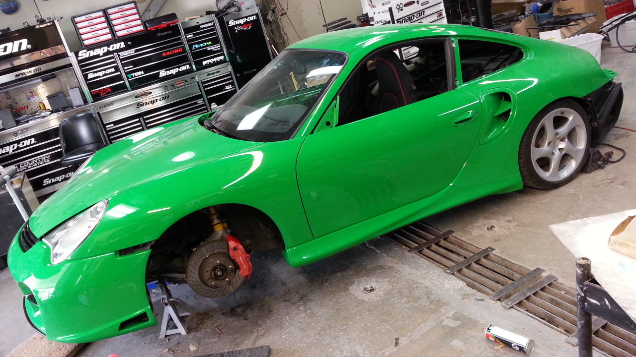

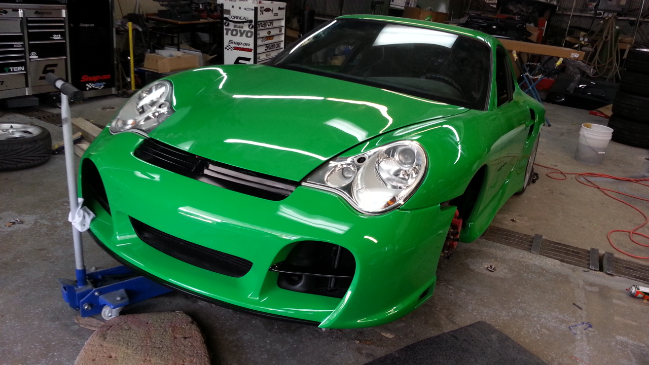

Slowly coming together. Just fitted the bumper. Aligning the damn headllight took the longest. What a crappy design!
Just waiting on more plastic/rubber pieces....
Anyone know if there is a company that sells brake rebuild kits. I want to take these apart and get them powdercoated.

Looking great so far We offer all the hardware you need to rebuild the calipers. For more information Click Here
Old Oct 10, 2013 | 01:30 PM
32krazy!'s Avatar
Joined: Dec 2008
Posts: 5,551
From: tn
Rep Power: 628
try this company. http://www.zeckhausen.com/StopTech/consumables.htm stoptech brakes use the pistons and seals that brembo brakes use. i was able to rebuild a set of 6 piston brembos for my amg when i had it

Thanks. I'm going to disassemble them and see what I need.

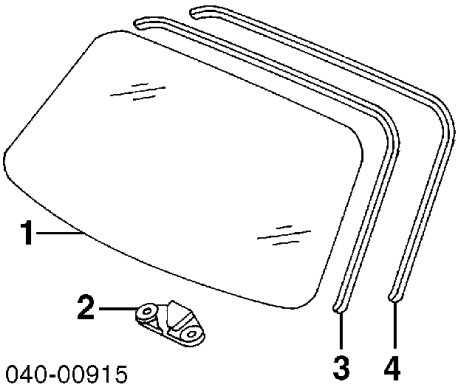

My molding is show it's age...how hard was it to remove the front windshield molding and the belt molding that wraps around the rear quarter window to the front drivers window.

If you're careful, it's easy. There is a metal retainer around the window(#3) and the rubber gasket(#4, the part you see and wears) goes on top of it. If you pull it wrong, the metal retainer comes out with it. If this happens, you have to pull the windshield so be careful. Use WD40.
The one that wraps around the quarter glass is installed with rivets from the factory. The moldings are expensive. The quarter glass needs to come out. It's not hard for me cause I own a body shop but for DIY, it might be a little complicated. I would get a shop to do this.

Thanks for the info!
