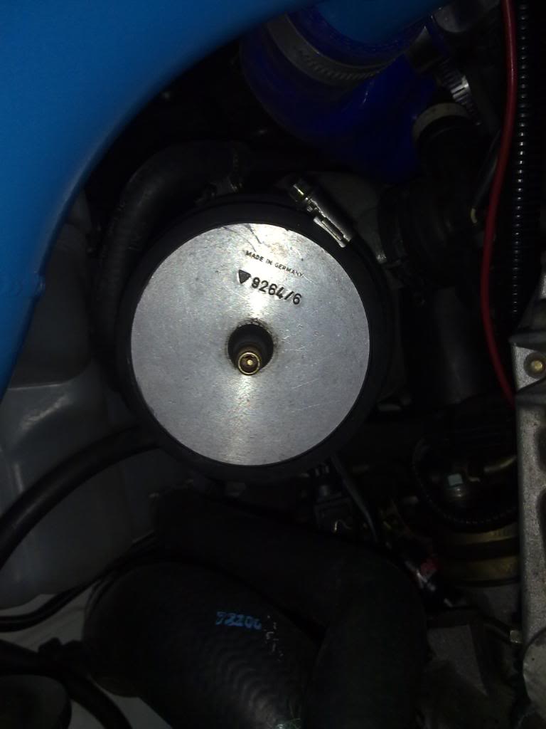

Pressure tested at turbos, all air seems to be leaking from air box?
I was told this could be check valve? Any experience on this?

Yes that's normal. Need to plug that hole.

The link you sent says to pressure test at the compressor at both turbos (block one, put air in other) and does not mention blocking off intake..

Probably the check valve - trace it back - may need to take your air filter box out to get better access. There are a lot of lines in that area near the intake.

is there air coming from the drivers side black plastic hose right next to the turbo> its plugged in to the piping that hooks up to the turbo.... if so its the check valve on top

yes you are right, error in memory. blocked it off there to isolate leaks post MAF.
