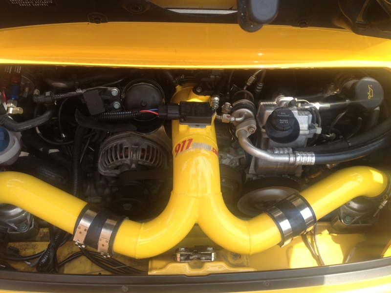

Got some info about my MAF:
The MAF that was in, and which they replaced with a new one of the same is a Bosch Unit # 0261230042. The link below shows that it is "compatible" with my car....
They tried fitting a regular MAF but said it did not fit because of the custom MAF/Y pipe set up...so they reordered a new unit of what was already in there.

Thats not a MAF thats a MAP sensor you need to get a new mechanic lol. Your MAF sensor is by the air intake. MAP sensors dont go easily.
I thought MAF and MAPs, while different, essentially achieved the same end?
The shop says I don't have the traditional MAF set up, I have a MAP instead.
From the DIY videos here, I can see where the MAF is supposed to be, I'll check my car...but does the 996TT have both a MAP & MAF....I thought it was usually one or the other...and that MAP was a possible way to go for high boosted cars?
