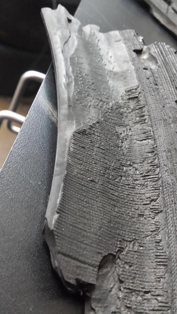

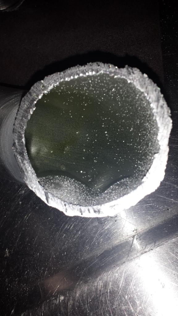

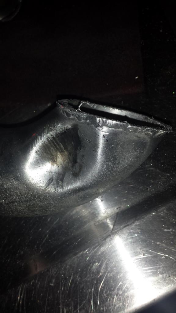

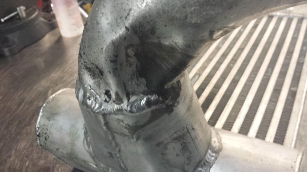

Hear are pics of the tire and what it did.
Now this charge pipe is pre intercooler and on a elbow..
Now here is where the money that I spent on data logging pays.. My Emap (exhaust manifold absolute pressure) was up. That tell me there is something wrong, its more often then not a boost leak. In this case it was a smashed pipe. This happens because the turbo needs to work harder to move the same cfm to make X power. The wastegate closes and the Emap goes up to hit the map (manifold absolute pressure) psi you controller is targeting. Thank you again for the support!!!

thats a strange delamination on the tire were they old?

Originally Posted by OS Inspector
tim, are you 3.8? and what boost pressure did you achieve all this with?
I am a 3.6l and use stock pistons (thank you pumptech ) that was 29 psi I was only setting up the boost control.
