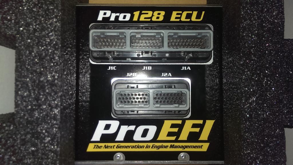

Here is a breakdown of what Undercover installed for me:

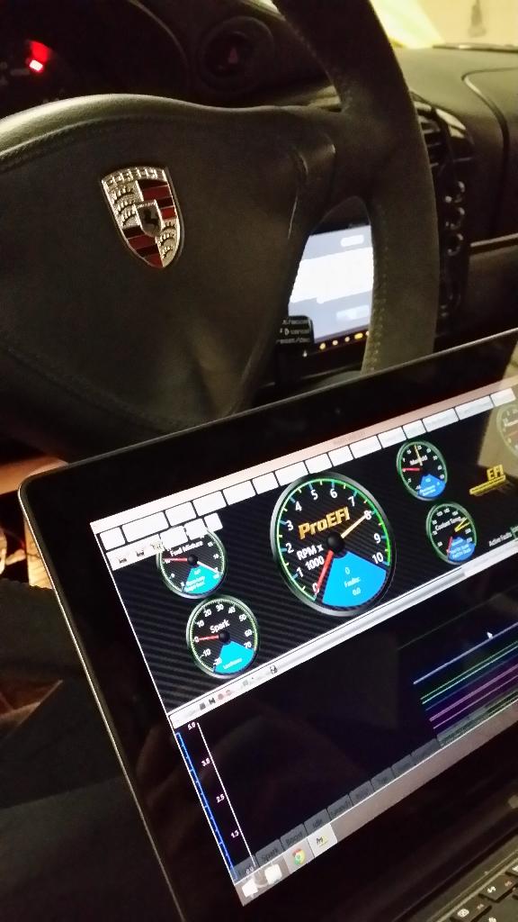

ProEfi 128 ECU
ProEFI 996TT PnP Kit

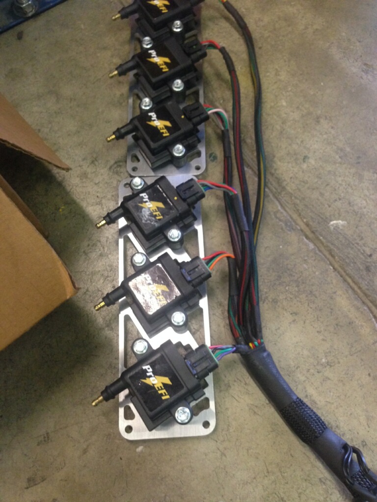

ProEFI H.O Coils
ProEFI CAN Display/Logger
ProEFI FlexFuel Kit
ProEFI EGT Kit x2
ProEFI 5bar Exhaust Backpressure Kit x2
ProEFI Air Inake Temp Kit
ProEFI I-Boost Controller
ProEFI Boost Control Solenoid
ProEFI 5bar MAP Sensor Kit
ProEFI Fuel Pressure Kit
ProEFI Wideband O2 Kit x2
ProEFI CAN Communication Cable

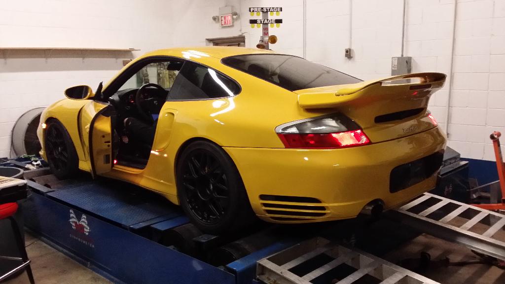

Here are some pictures:

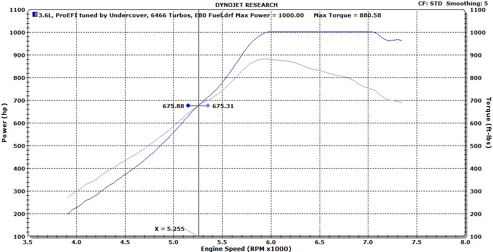

The weather just started getting warmer here and I've had my car home for about a week, I've been trying to drive it everywhere I can. Garth did a great job dialing the car in for drveability and full kill is very fast. He spent many many hours on my car trying to get things right such as ignition, throttle body calibrations, fueling etc. The car made 1010whp on Undercover dyno which is the same model used by EPL and reads similarly low. At this point he is the GO TO Porsche ProEFI man, over the winter 3 ProEFI 996TT cars making 1000+ whp on his Mustang Dyno and 2 more 900hp 996TTs in the works.

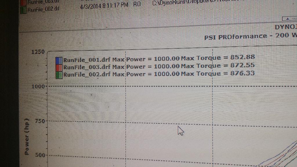

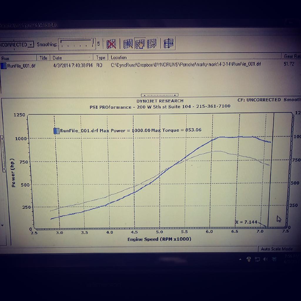

We decided to go back to the independent Dynojet I have used in the past at PSI Proformance to see what the car will do and back our numbers up since most people prefer to compare Dynojets and they generally tend to read similarly to other Dynojets. We also wanted to compare how close the ProEfi calculated HP field in the ECU will be to the Dynojet since it has been know to be very close (our logs showed 1150+ hp)
Well this happenned lol..... needs some software update
Power just got to 1000whp and stopped reading there.

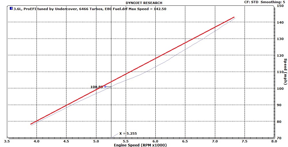

wheel speed line should be flat just like the red line i drew with paint, when its not flat means wheels are spinning

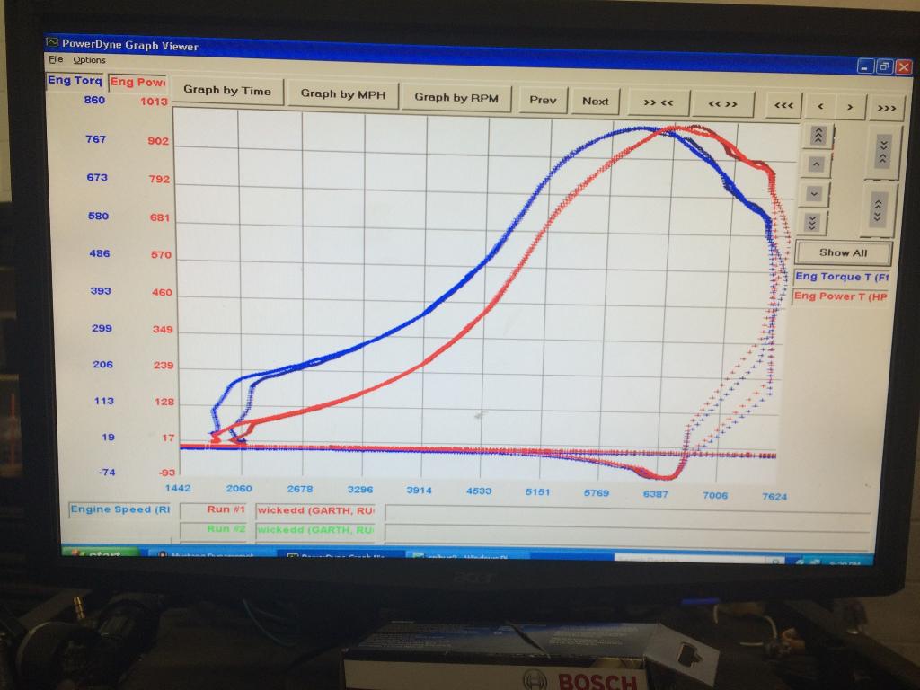

Before people ask, yes we know my power drops off at the top. That is because we are making over 1100hp on essentially a stock 996tt engine. Yes it is reinforced with Carrillo rods, but pistons are stock, cams are stock, valves are all stock. I dont believe this level of power has ever been achieved on stock cams and valves. Garth spent hours playing with Variocam to maximize the factory setup. Some people will wonder why bother, answer is simple because we can and we want to know.
Cams are next. Tim is cooking up something special, we dont have details yet.

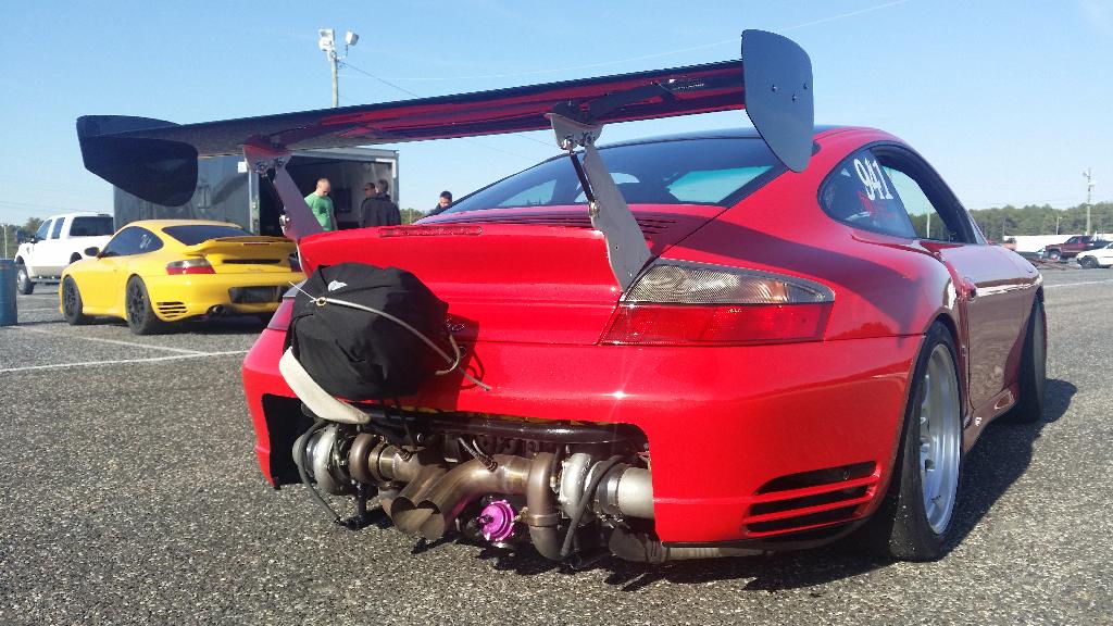

I took it to the track sunday to get some shakedown passes on 18" wheels, not my 16" CCW drag pack. I drove the car 30 miles to the track, pulled up the front wheels twice, made 7 low to mid 10 sec passes over 150mph and drove it 30 miles home all on same E78 fuel right out of the gas pump for $3.79 a gallon. We also had the PBox hooked up for some of the runs for the heck of it and got some cool data.

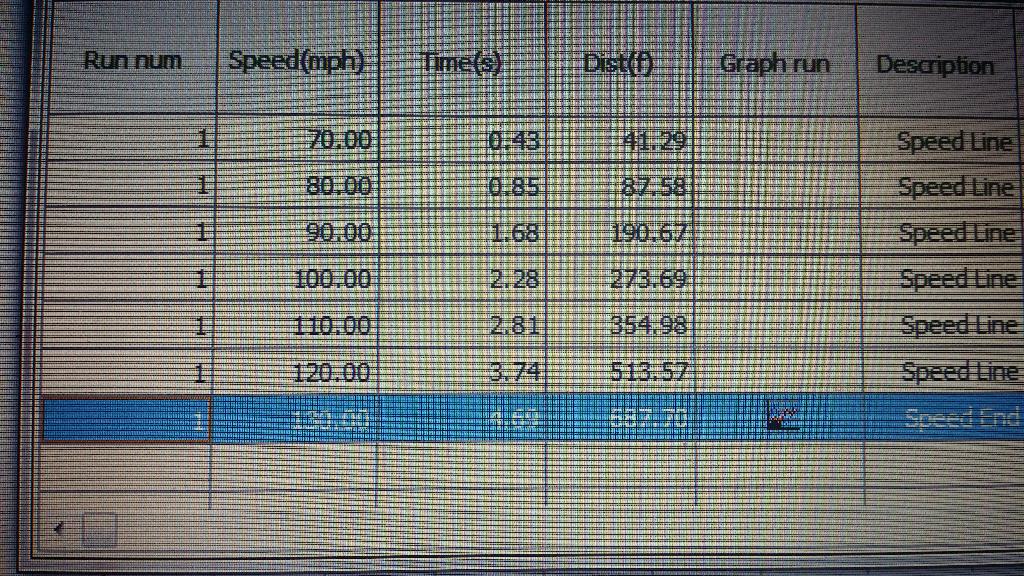

0-60MPH 3.3sec (1 shift)
60-130MPH 4.69sec (2 shifts)
100-150MPH 3.95sec (1 shift)

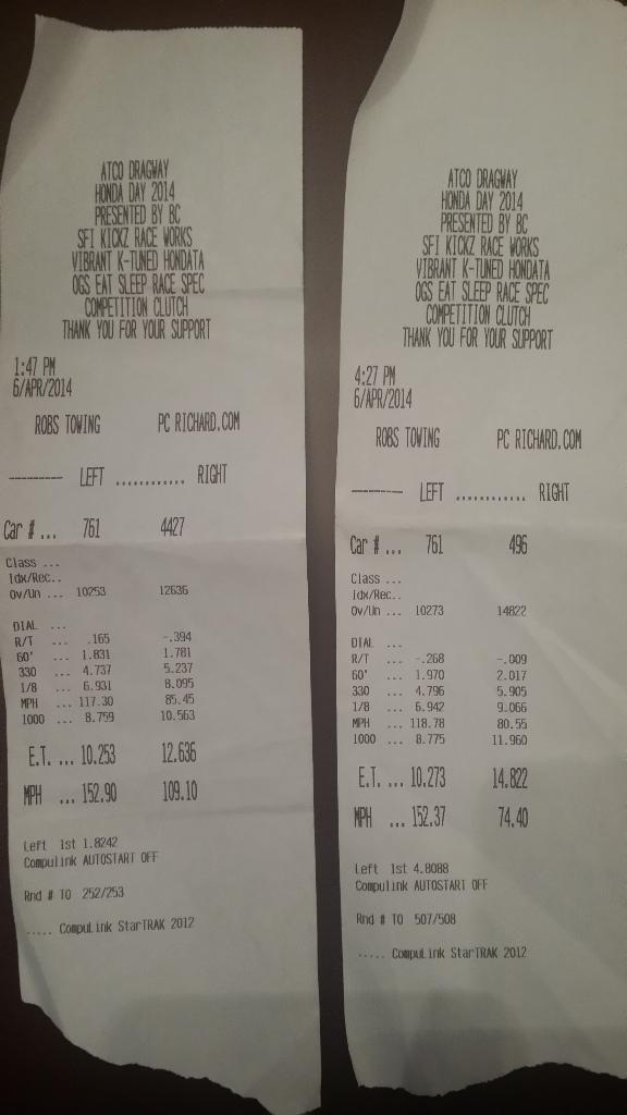

Best 1/4 mile trap on PBox 154mph
Best timeslip was 10.25 @ 152.9MPH
60-130
Completely flat surface with no decline and with 2 shifts !!!!!!
