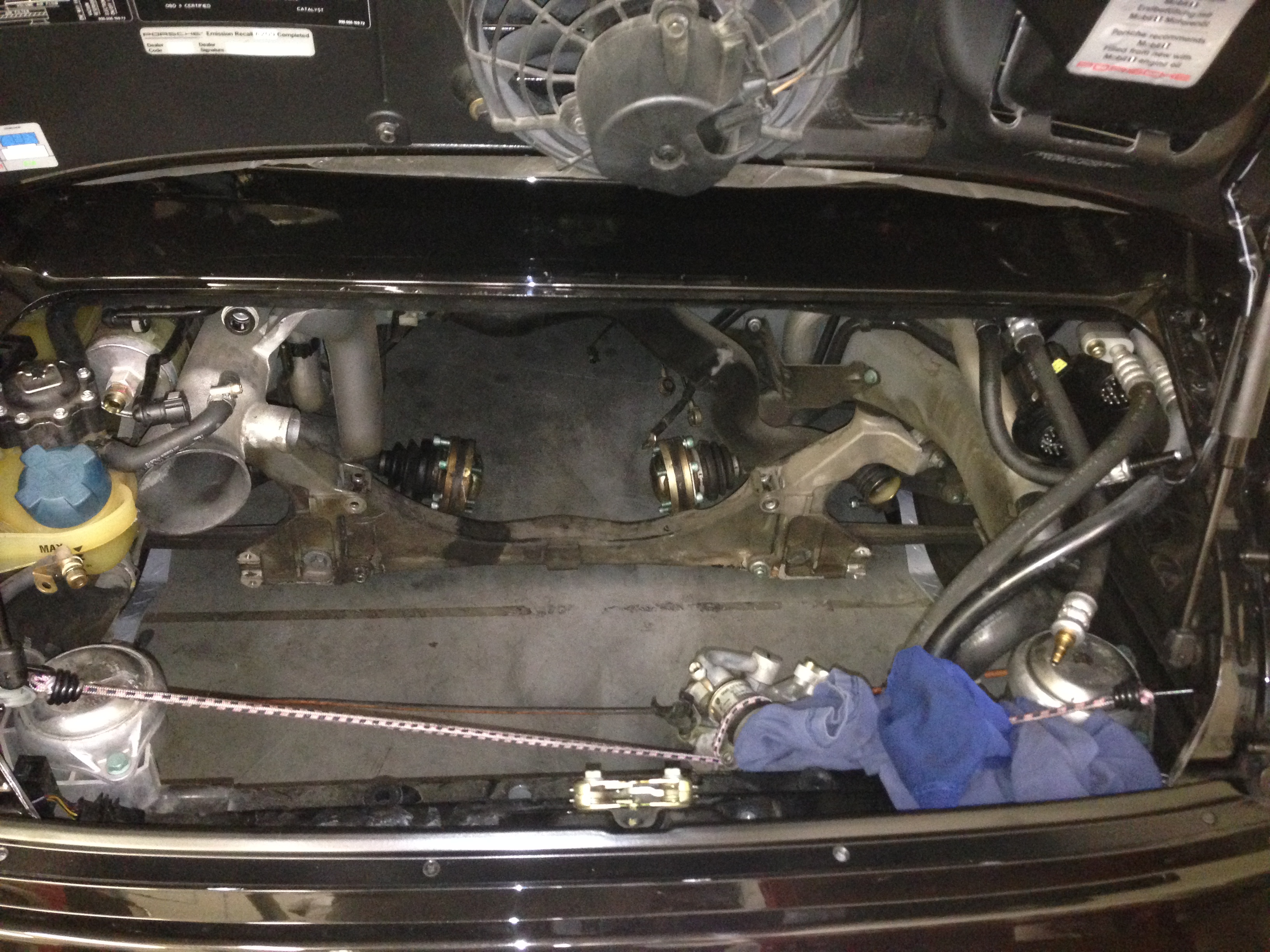

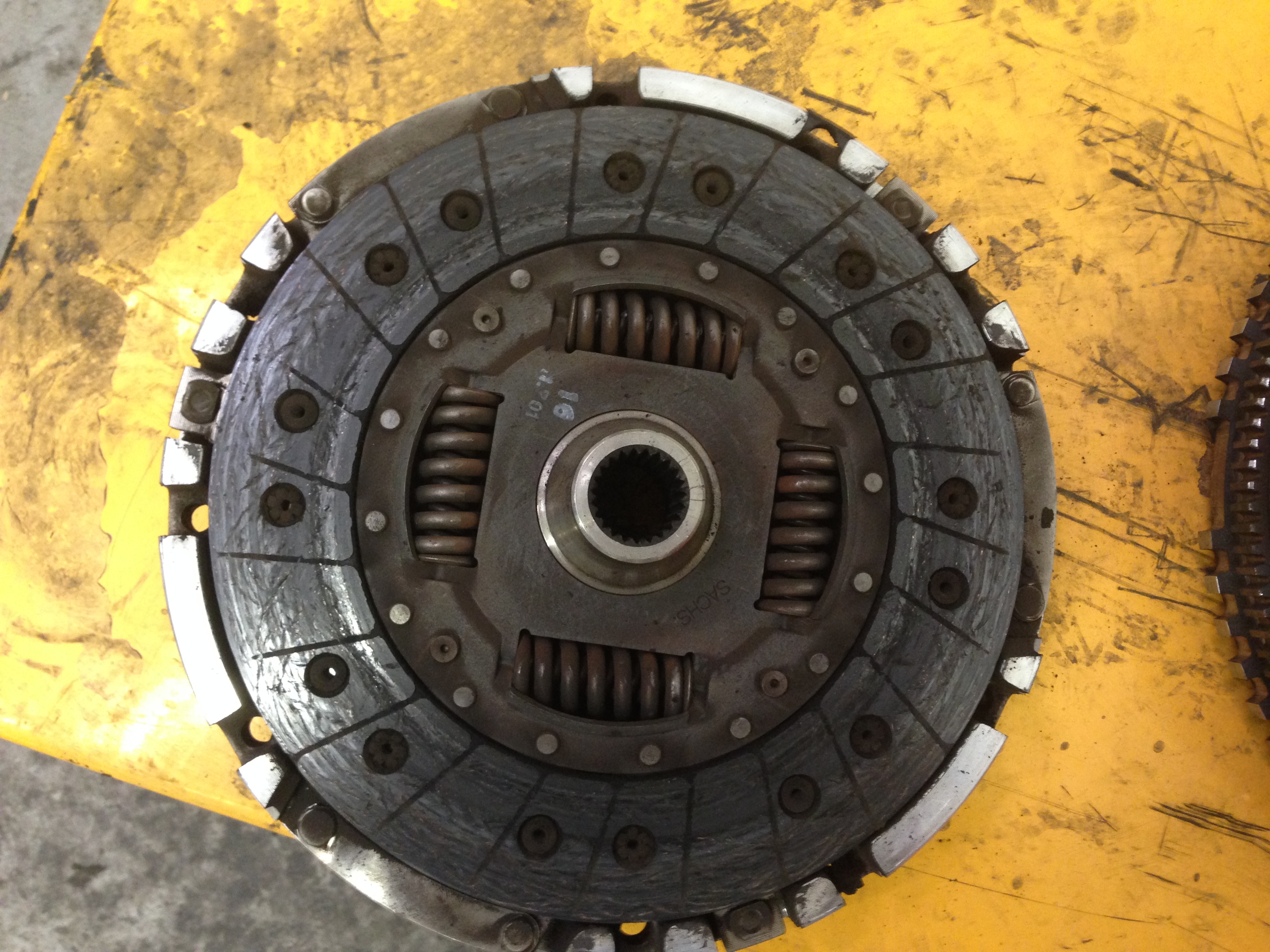

Went to check my progress of my car yesterday and to drop off some parts the clutch looked better then I thought. It wasn't even touching the rivets so we think the pressure plate was going south causing slippage. The flywheel looked great no burn spots so going to use my original stock dual mass.
Name:	photo 5 (3).JPG
Name:	photo 2 (6).JPG

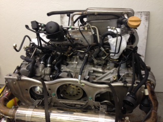

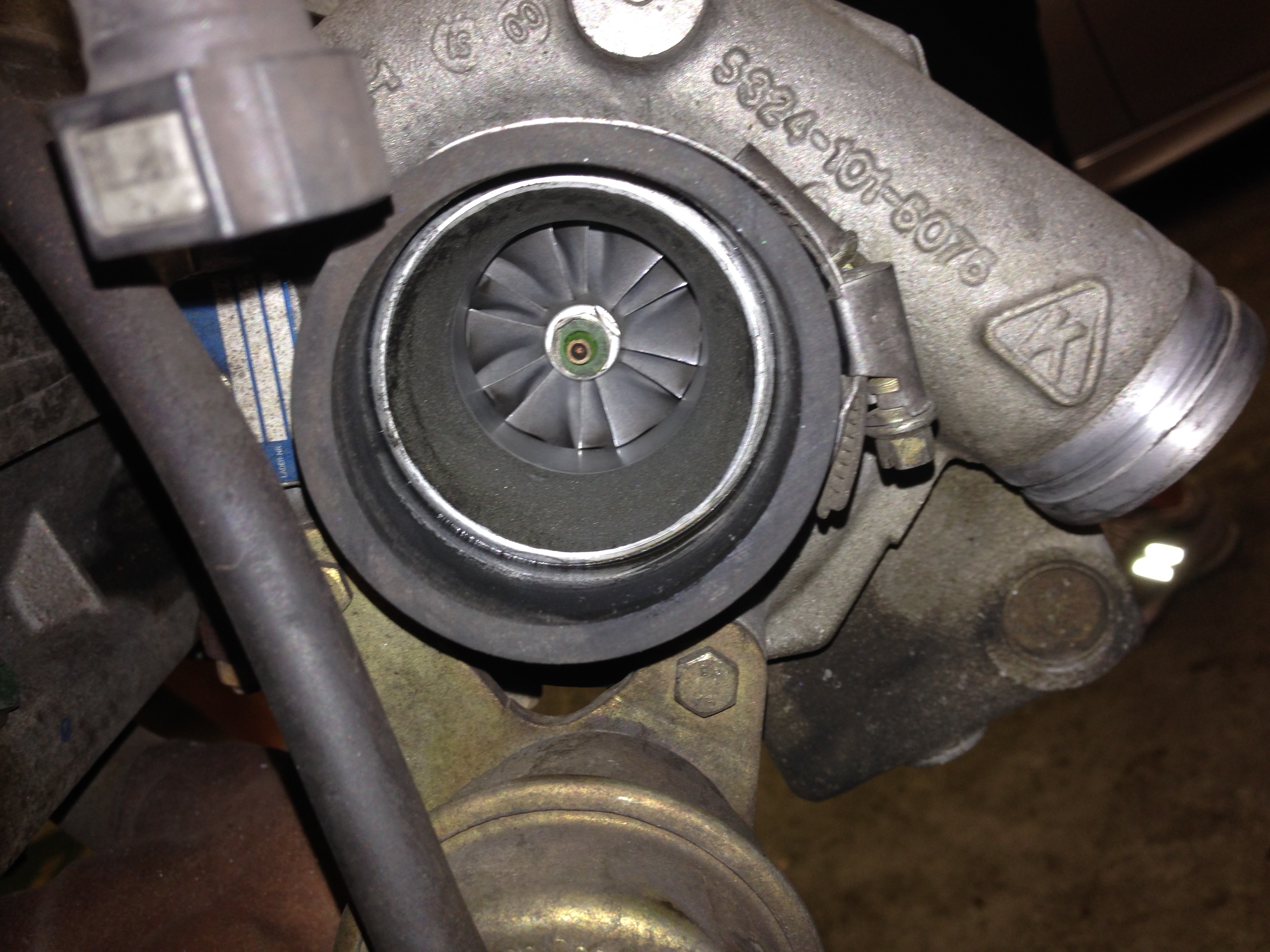

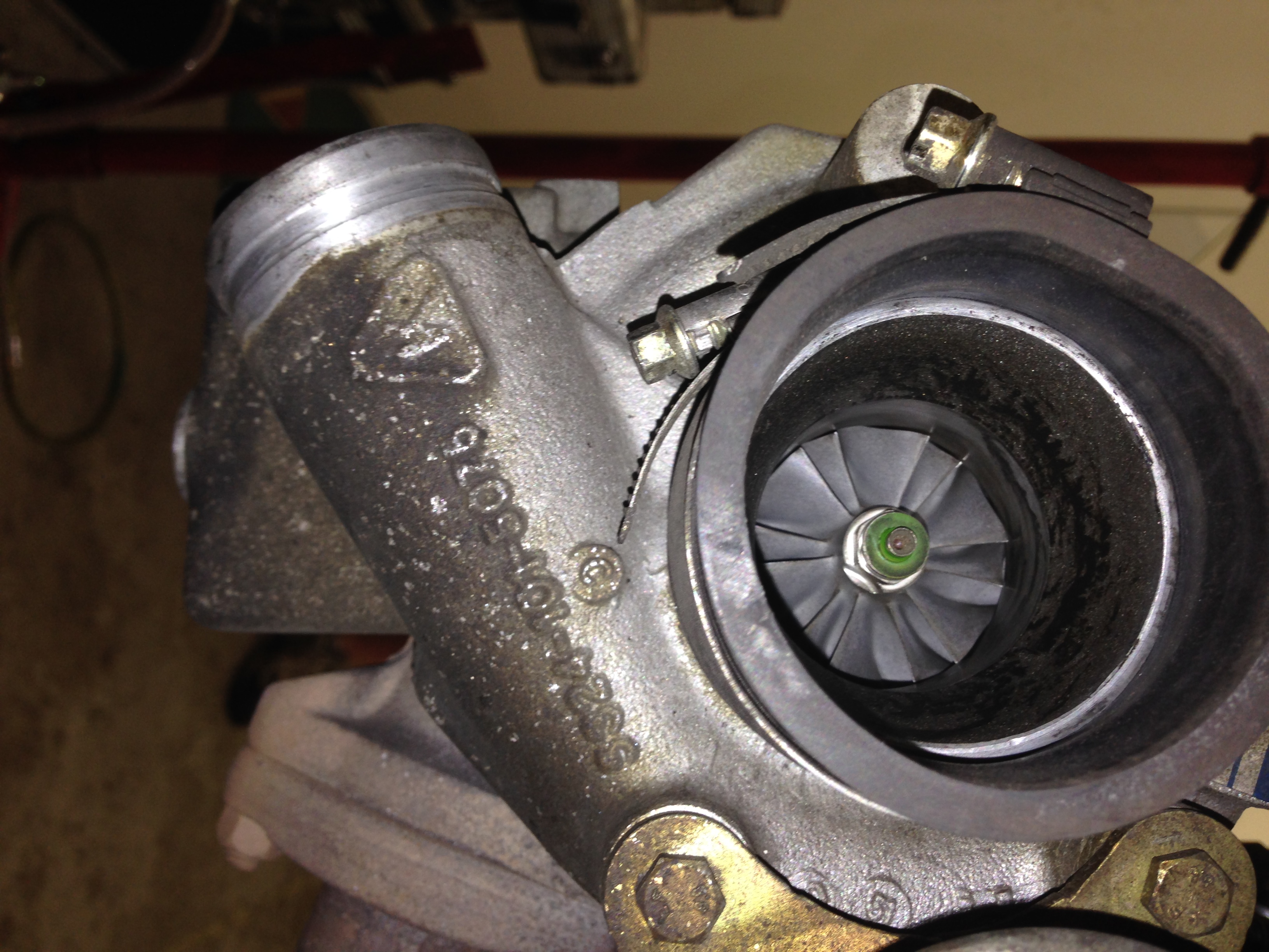

Since my engine was on a stand I took pictures of my turbo's wheels they looked great I have 38,500 miles and have had a Softronic 91 octane tune since 13,000 miles on stock K16's.
Name:	photo 1 (2).JPG

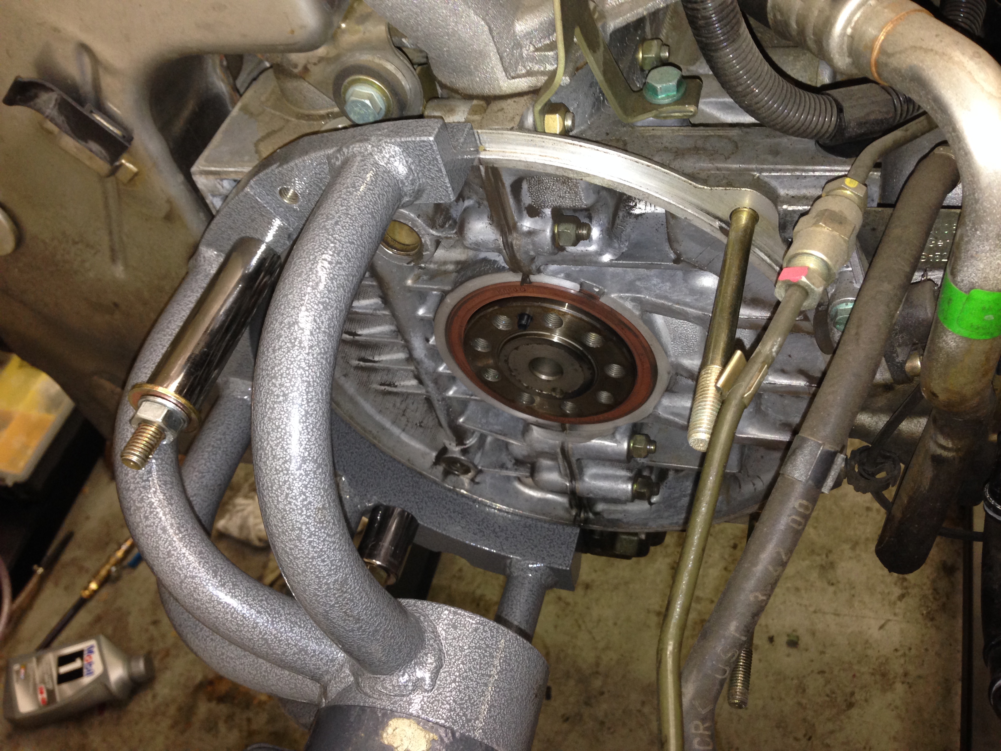

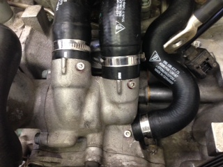

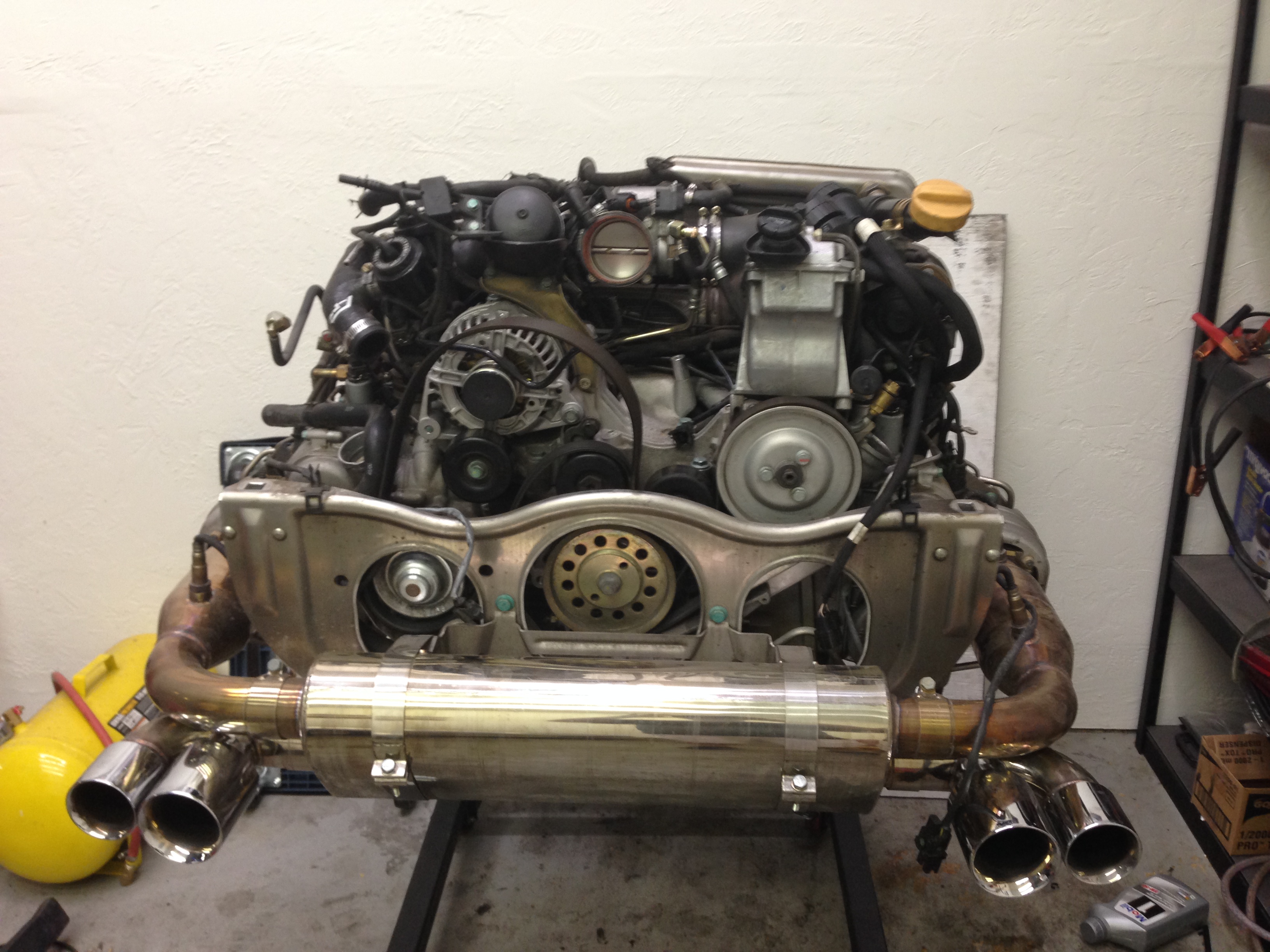

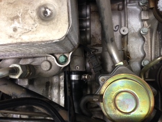

Coolant lines all pinned with new hoses.
ID:	387700   Click image for larger version
ID:	387701   Click image for larger version
ID:	387702   Click image for larger version
ID:	387703   Click image for larger version

You may as well throw a new fuel filter in there since it's not much and so easy to access with the motor out. Otherwise looks good and I'm sure you're excited about getting it on the road again!
Old Jun 16, 2014 | 01:26 PM
602996TT's Avatar
Joined: Nov 2009
Posts: 344
From: arizona
Rep Power: 45
602996TT has a brilliant future602996TT has a brilliant future602996TT has a brilliant future602996TT has a brilliant future602996TT has a brilliant future602996TT has a brilliant future602996TT has a brilliant future602996TT has a brilliant future602996TT has a brilliant future602996TT has a brilliant future602996TT has a brilliant future
Thanks I forgot to list that but I did put a new fuel filter as well. It's been two months since I have driven my car I can't wait till I get it back on the road!
