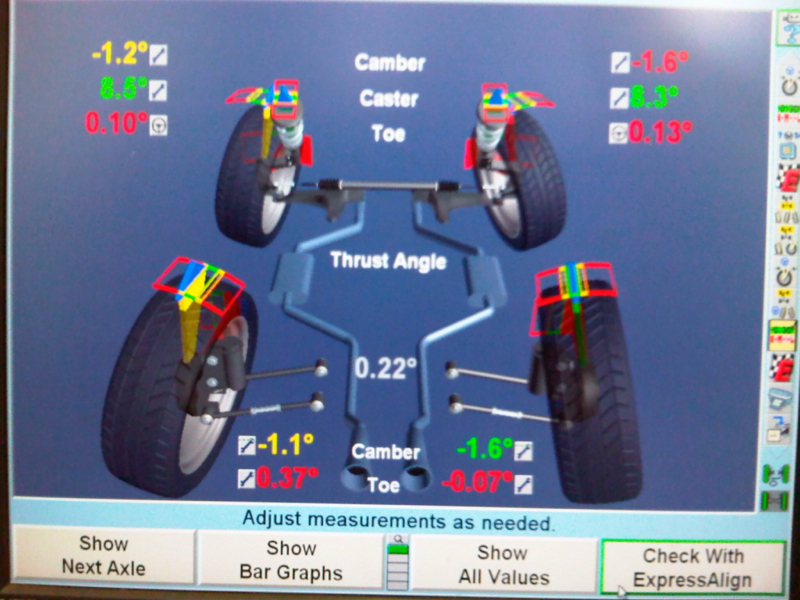

Id say it's more likely the camber or toe is out on the wheels than the springs are sagging. If the alignment is out even a few degrees it will make one wheel closer to the fender than the other. Guess there is a change the spring are sagging, but H&R are pretty good quality and i'd be surprised to find out they really are sagging. I think people have claimed this previously but it's sort of grey if it was really true or not.
Reason I say this is I have been there done that. 350z one wheel rubbed other didnt, was high in the wheel well looking too. Here was the computer diagram of my alignment. Wow.

I think you're onto something. I'm having them do a GT2 alignment tomorrow and will report back if it fixes the issue.
