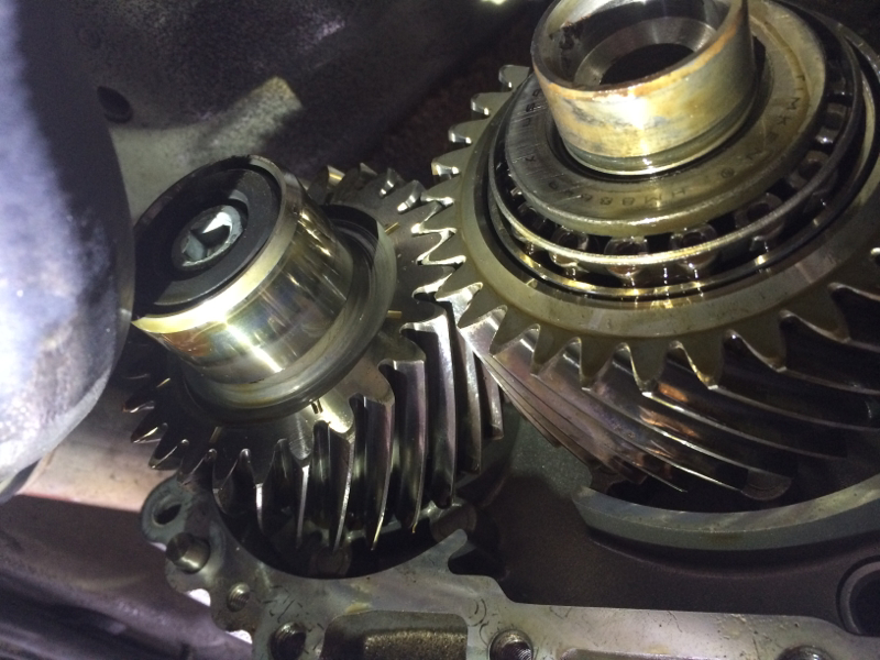

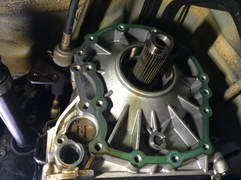

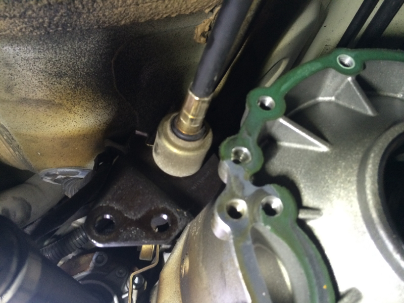

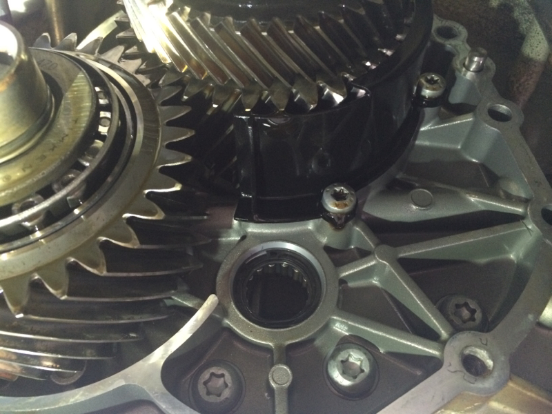

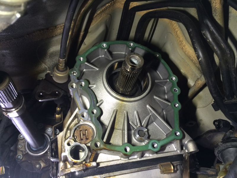

I may not have stayed at a Holiday Inn last night, but I feel like a different person now that I can park for a while and when I leave, my car has not left any oil spots! I jacked her up and removed the transfer case section. Cleaned everything, installed new gaskets, changed the filter and filled her with Pentosin! She shifts great with ZERO NOISES! The fill procedure that I have been reading about and studying did not apply to my Tip! There is no "magical" valve on the drain that closes automatically! I had to "improvise"! I got her full and she shifts better than ever! Don't think I'm qualified to do a write up on it,but, I will be more than happy to share my experience through PM's.
