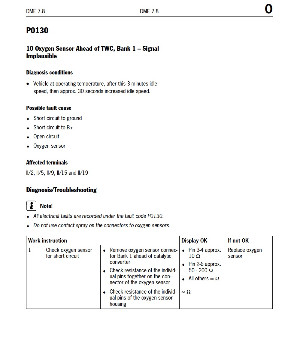

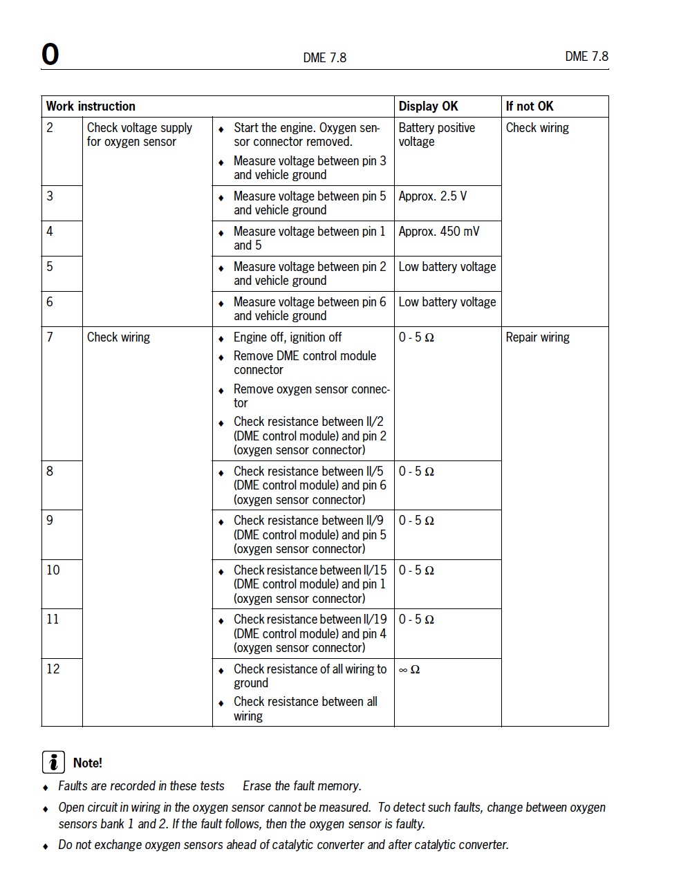

Here's what the OBDII manual has to say about the P0130:
Name:	Screen Shot 2014-07-14 at 20.05.22.jpeg
ID:	396516   Click image for larger version
Name:	Screen Shot 2014-07-14 at 20.05.33.jpeg

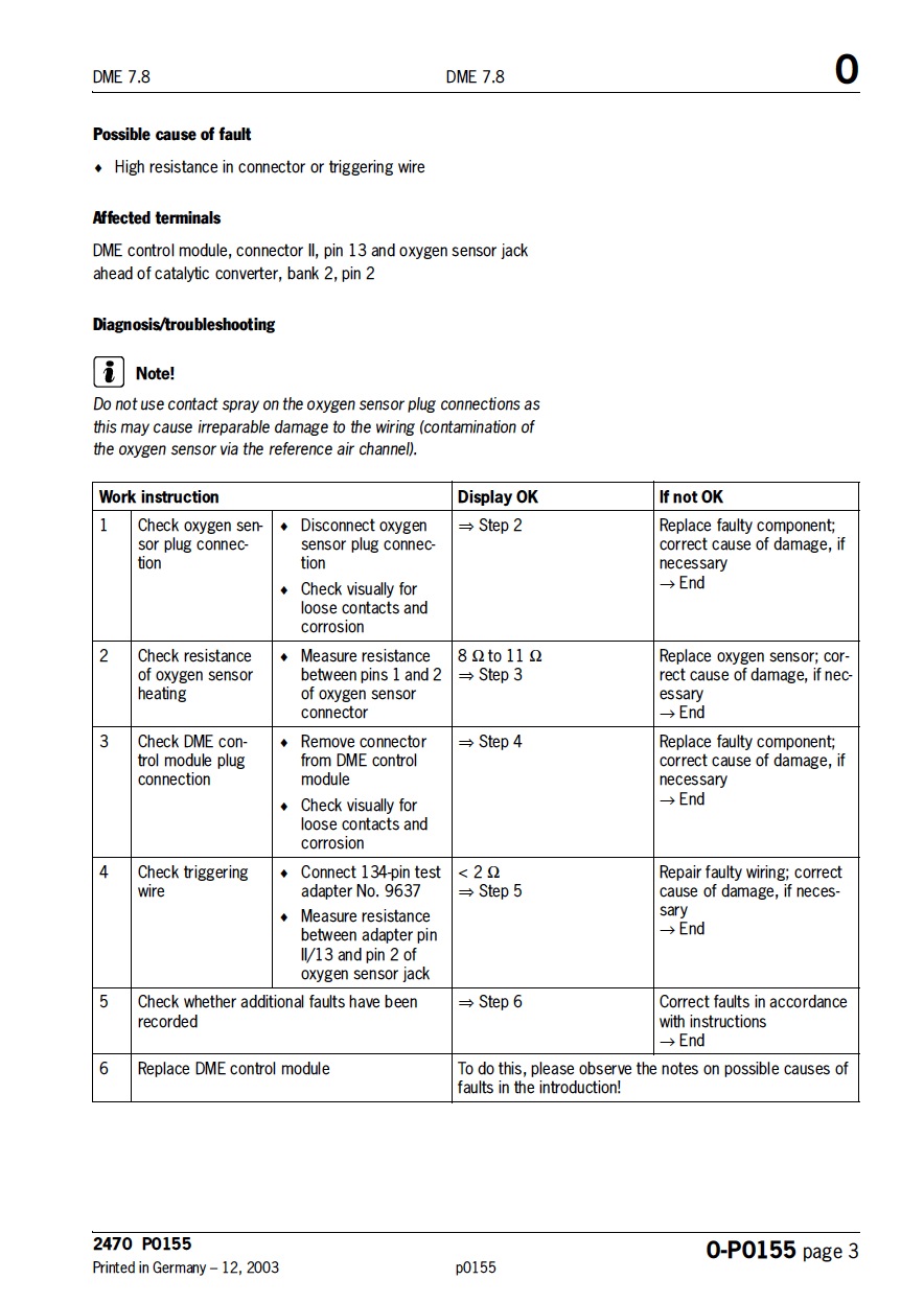

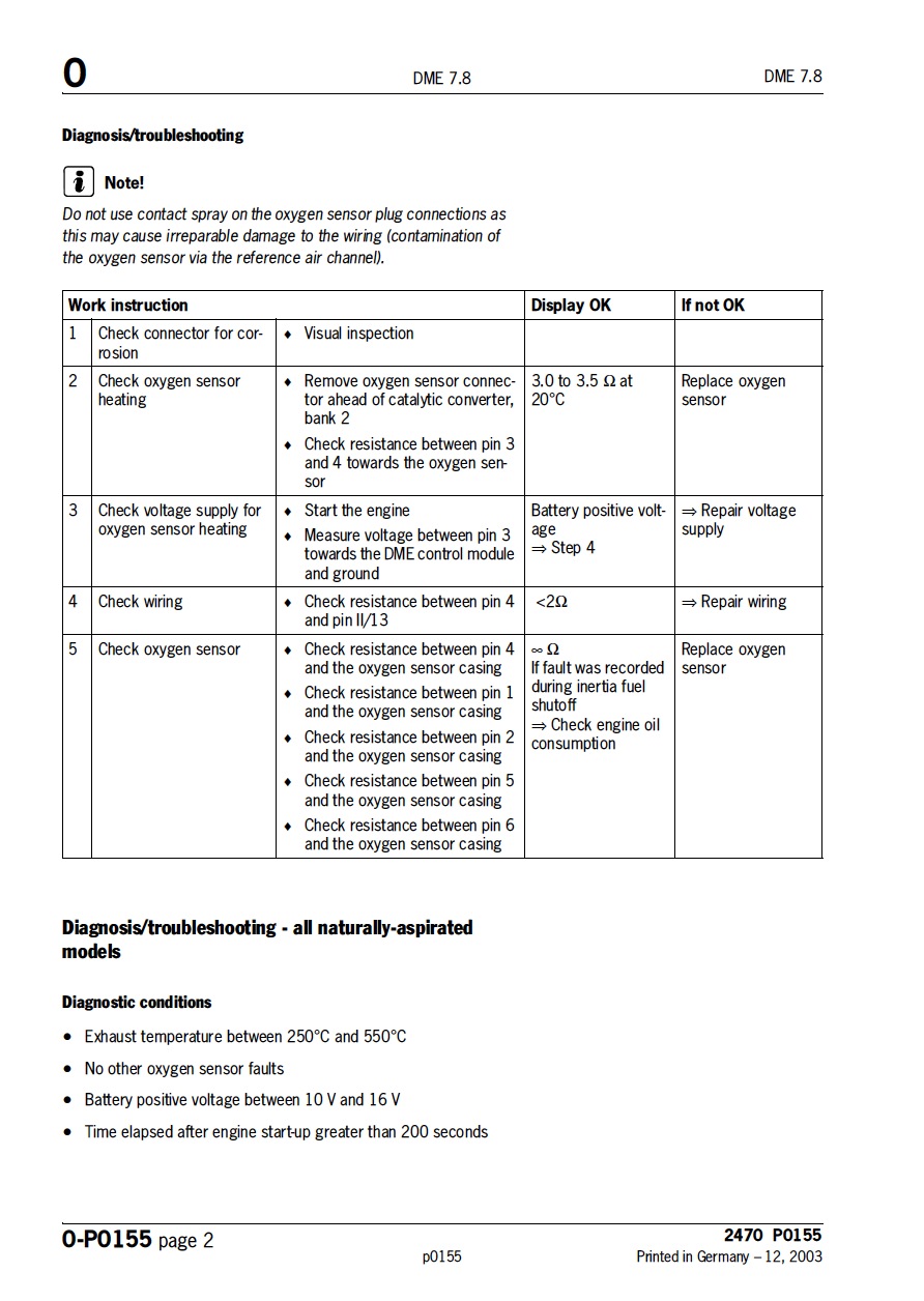

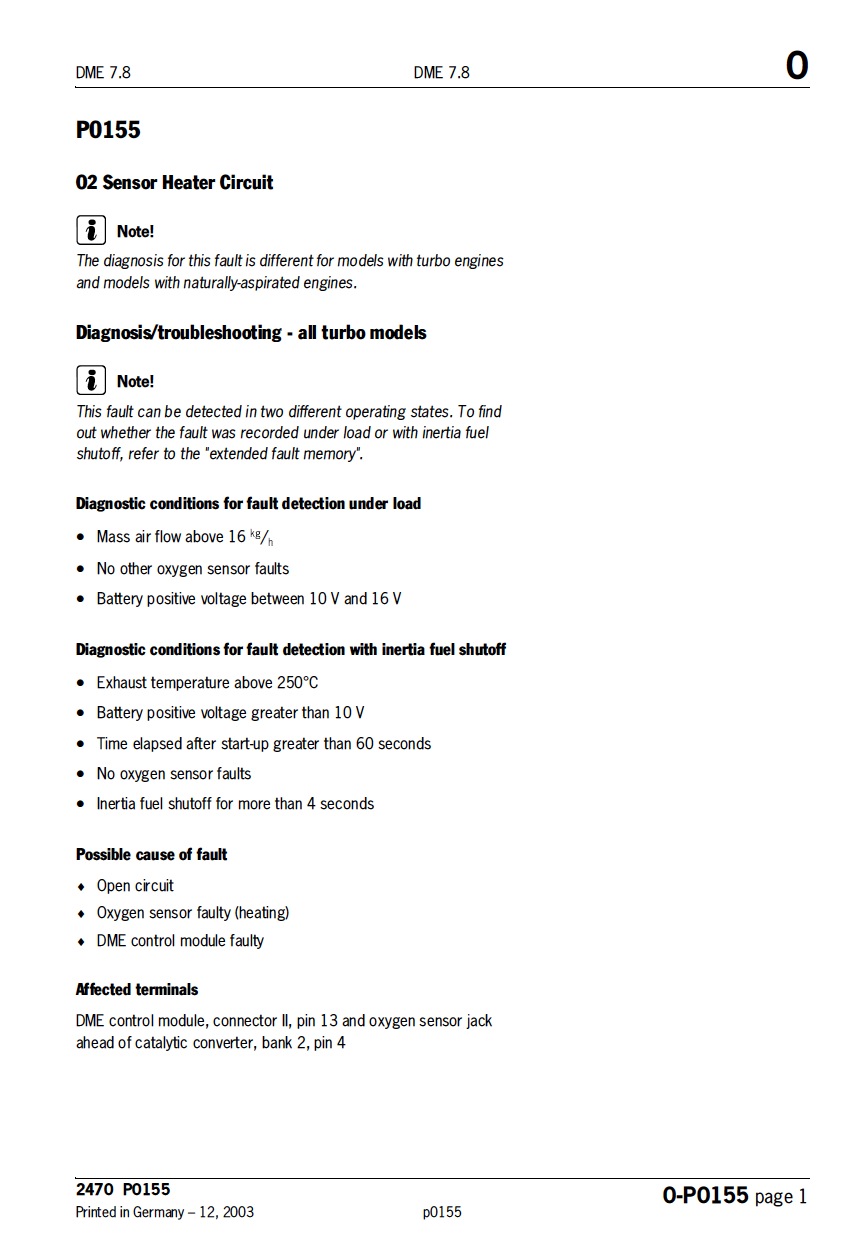

Old Jul 14, 2014 | 06:09 PM
jpflip's Avatar
Joined: Mar 2008
Posts: 2,807
From: Montreal Canada
Rep Power: 268
jpflip Is a GOD !jpflip Is a GOD !jpflip Is a GOD !jpflip Is a GOD !jpflip Is a GOD !jpflip Is a GOD !jpflip Is a GOD !jpflip Is a GOD !jpflip Is a GOD !jpflip Is a GOD !jpflip Is a GOD !
And about the P0155: I hate these kind of problems because they can be related to a bad tuning…..
Name:	Screen Shot 2014-07-14 at 20.08.16.jpeg
ID:	396518   Click image for larger version
Name:	Screen Shot 2014-07-14 at 20.08.27.jpeg
ID:	396519   Click image for larger version
Name:	Screen Shot 2014-07-14 at 20.08.36.jpeg
